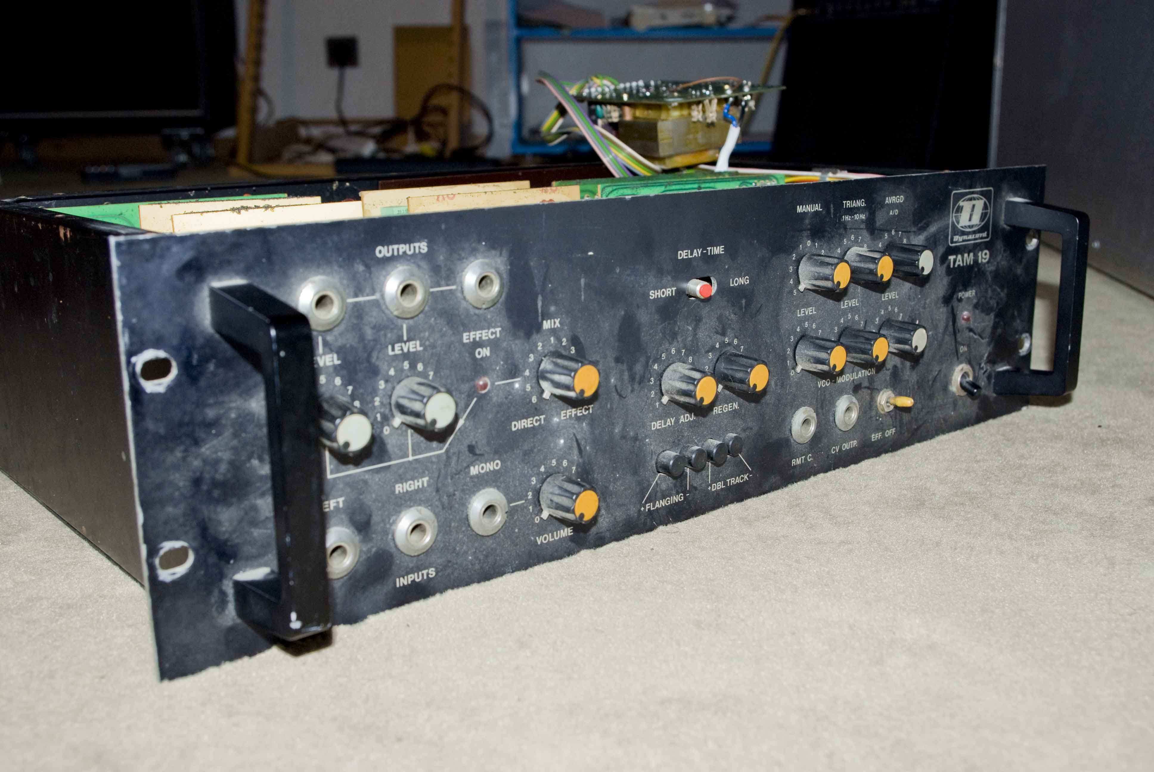

Ok, so i just got a Dynacord TAM 19 (Time Axis Manipulation System) for super cheap at a fleamarket.
The top side of the case has some rust on it, and the pots' movement feels like they're done.
To my surprise it looks quite ok on the inside, no missing parts or signs of damage.

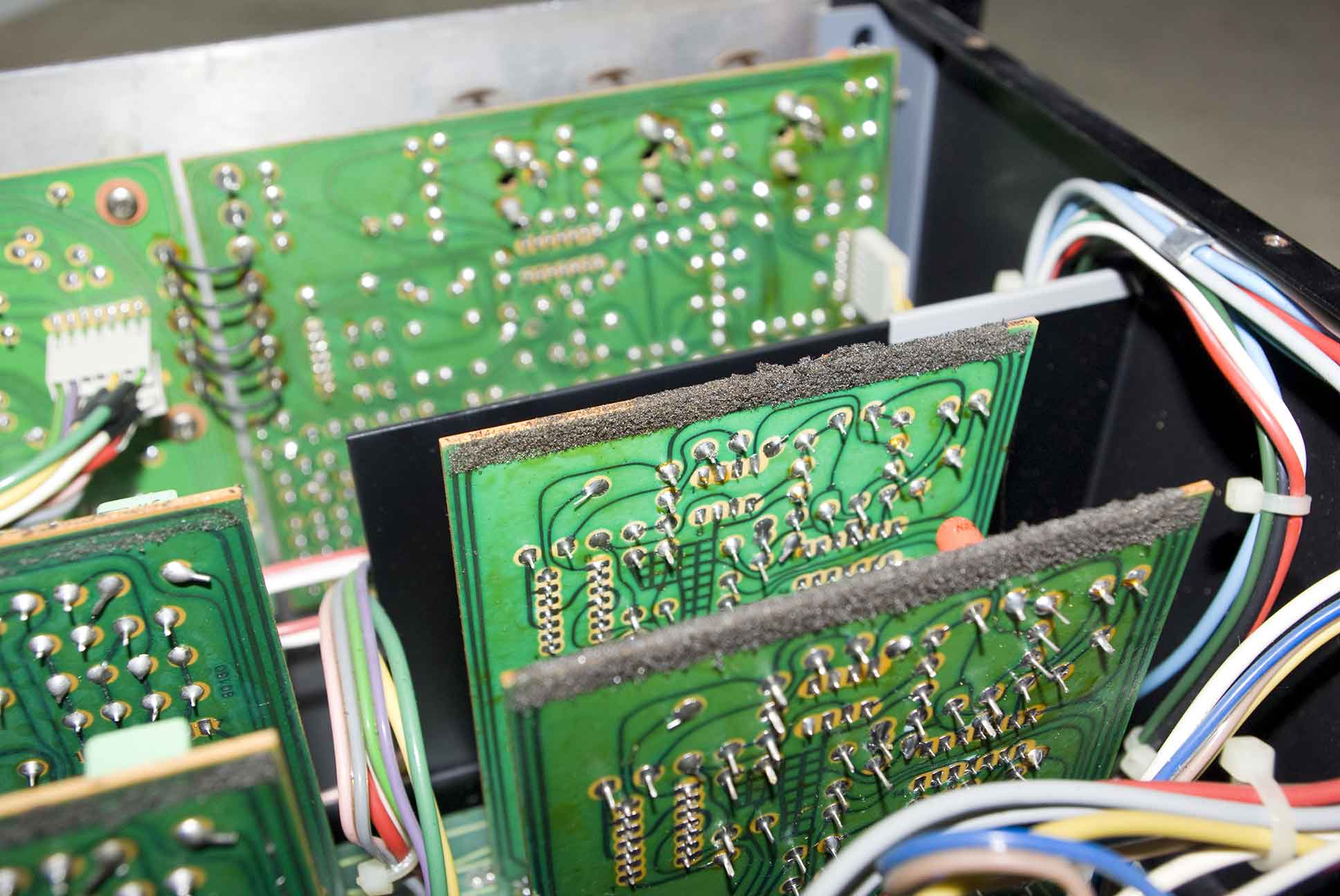

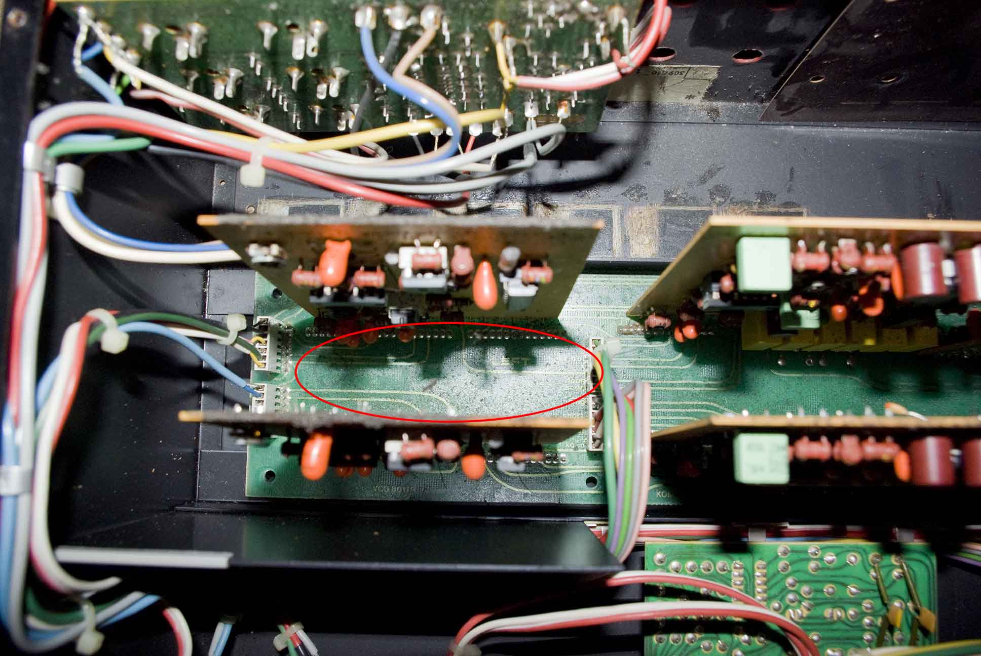

However, the foam which holds the vertically mounted PCBs in place (when the unit is closed) has completely degenerated, leaving lots of stains on the PCBs and parts. How should i go about removing that? Never done that before...
Also, could the remains of the foam cause shorts in the circuit?

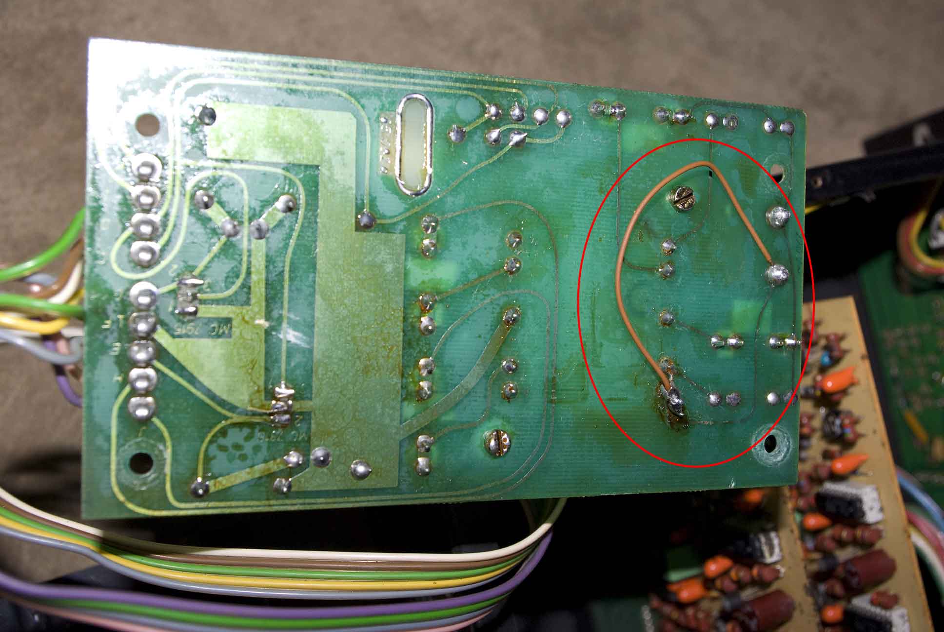

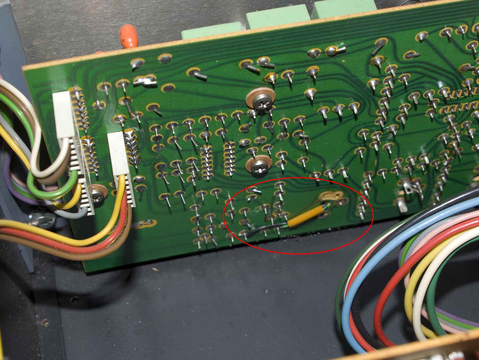

It looks like someone has done a repair job on this one. The PSU has a wire jumper (and a missing fuse!), and on one of the PCBs two solder pads where removed and replaced with wire jumpers. Gonna have to check this.
In conclusion, this doesn't look like it's a hopeless case. I'm going to completely disassemble and clean it first, and then try to power it up.
What should i use to clean up the remains of the foam?

Ok, i'm rephrasing my question:
What's the best way to clean a circuit board from old, degenerated foam?
this stuff is very sticky, so i can't just brush it away.
I have no clue, please tell me Very Happy
PostPosted: Wed Sep 23, 2009 4:56 am    Post subject: Reply with quote  Mark this post and the followings unread
Brush and/or wipe it away as much as you can, then I'd use some CRC contact cleaner to get rid of the rest of it. Any hydrocarbon based cleaning spray would probably do it too.
Check for leaking electrolytic capacitors while you're cleaning, especially around the PSU, and replace them before powering up.
Thanks. Smile

PostPosted: Wed Sep 23, 2009 6:07 pm    Post subject: Reply with quote  Mark this post and the followings unread
Check out the Realistic MG-1 sites for tips on getting rid of the foam residue. I would even consider leaving it on the surface of the PCB where it won't affect connections or solder pads. This stuff is right very gummy, I had decent luck with Isopropyl (Rubbing) Alcohol. Strong solvents might cause more damage than the gummy residue would. If it's not in a switch contact, slider, pot, or a Card edge connection, leaving it alone may be the better part of valor, at least until you know if the thing is going to work or not.

Can you disconnect the PSU and check whether it has "reasonable" outputs before you try the complete unit? While you're there, "look into" the PSU connections for the rest of the unit with your DMM set for resistance. A complete short or open circuit there would be another very handy clue before applying power. (try swapping polarity of your DMM too)

PostPosted: Thu Sep 24, 2009 4:29 am    Post subject: Reply with quote  Mark this post and the followings unread
That is probably the best way to go about it.
I was thinking that the foam residue may cause some weird electrical side effects, therefore i wanted to get rid of it.
Yes, the PSU is on it's own PCB (there are *12* PCB's in there!). It'll be the first thing i check.

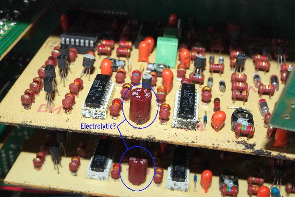

However, there are some caps (see attached pic) where i'm not sure if they're electrolytics or not. Are they? Smile
Are the big brown thingies electrolytic capacitors?
 Filesize:  328.67 KB
 Viewed:  271 Time(s)
PostPosted: Thu Sep 24, 2009 6:14 am    Post subject: Reply with quote  Mark this post and the followings unread
Yeah, they're electrolytics.
It looks like it's got plenty of polystyrene caps as well. They are very stable and accurate. It must have been a good quality unit in it's time.
The orange blobs are tantalum caps. I think I remember they can go belly up too over time. Or was it that they tend to go short circuit when they fail?

Thanks, about 20 of those in there. Not too bad.
The pic shows the two delay boards (you can see the TDA1022 in the white sockets). Each has 10 polystyrene caps. On each LFO board there are two. The LFOs are actually VCOs, btw. (external CV input!)
Yeah, i too think that this was a pretty solid piece of gear. Inter-board connections are mostly done with headers, all IC's are socketed, and someone has done a pretty good wiring job.
Yeah, tantalum.
General question: What about polystyrene, wima, etc. caps? Do those too fail over time like the electrolytics?
