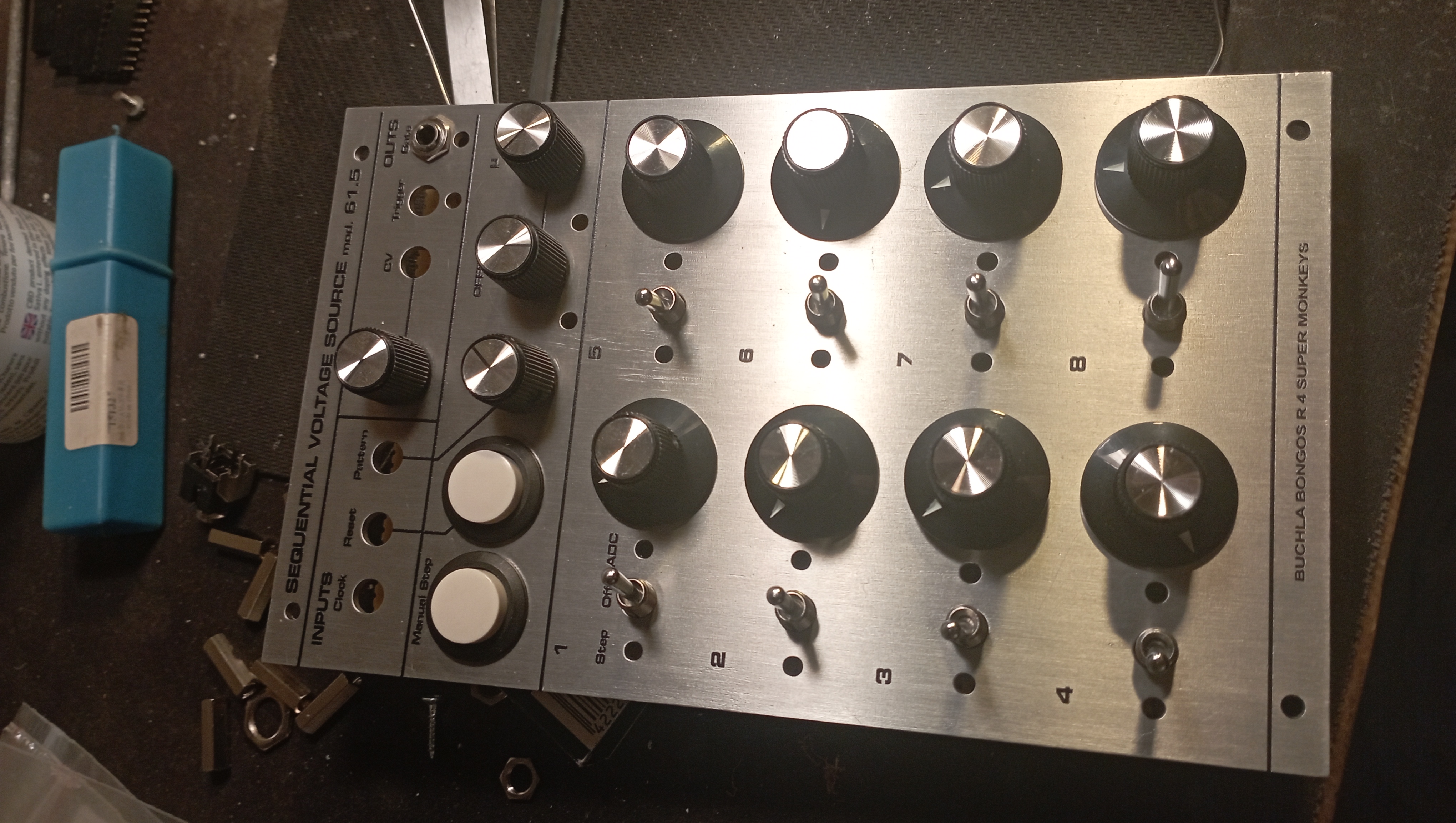

Almost done with the wiring of this long neglected project...
I realized now there are two CV outputs available....??
What's the difference between the "processed CV out" from W1 and the attenuated "CV out" from J2??

The processed CV out is just the input CV combined with the offset and fine controls. The CV out from J2 is the actual sequencer CV output from each step.
