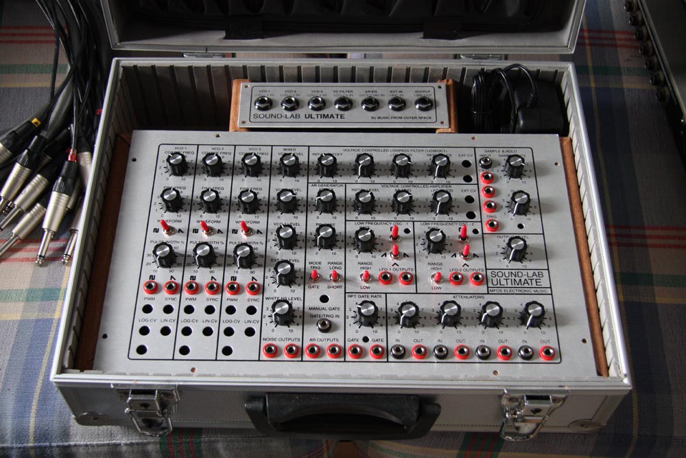

I've finished my board now, just mounting the panel in the case and wiring up now
 Filesize:  133.05 KB
 Viewed:  381 Time(s)
LektroiD

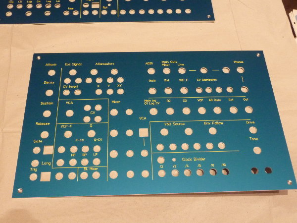

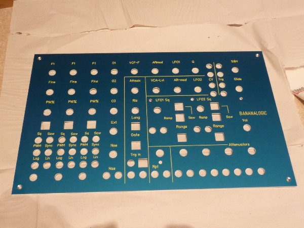

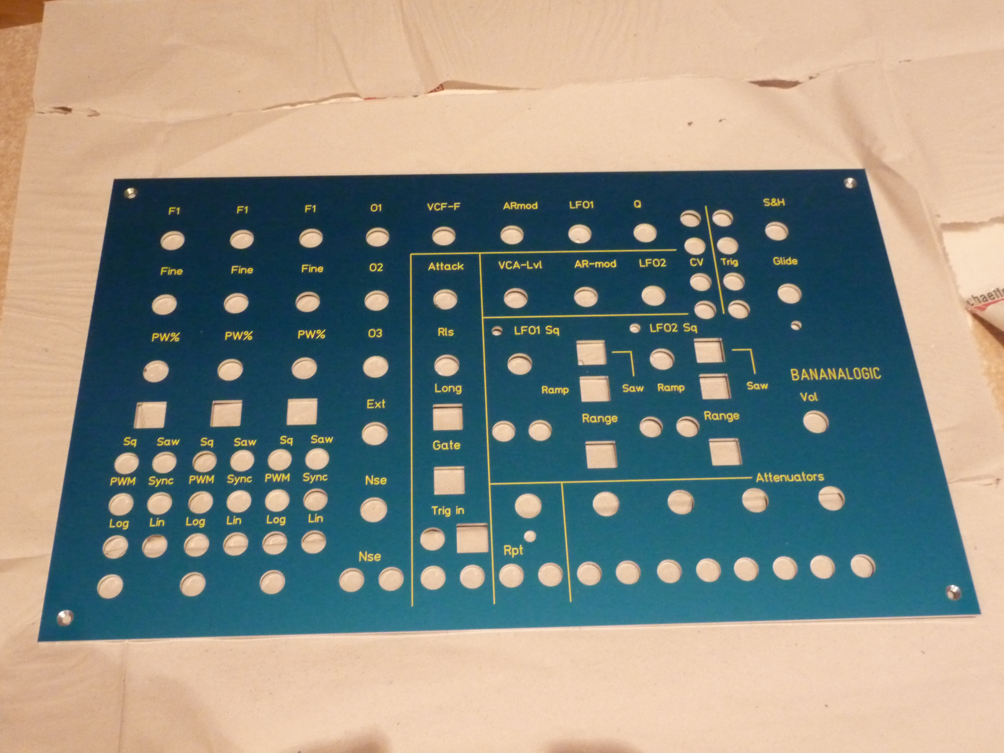

I'm not sure what is going on with attachments but hopefully you can see the panels I am using for my Ultimate/expander build. They are basically Ray's design but with a couple of minor changes. The second panel is the Expander and I have added the aux panels to this so all connections are on a front panel. This left me with a bit of panel real estate so I am adding a couple of variable voltage sources, a clock divider and a distortion unit.
The square cut outs are for the rocker switches I will use- I dont think silver toggles would work on my panel design. funnily enough the rocker switches are toggles with a cover!
More as it happens.
 Filesize:  1.84 MB
 Viewed:  415 Time(s)
 Filesize:  1.91 MB
 Viewed:  355 Time(s)

ashleym, they look great! What did they cost to get made?
LektroiD
ashleym
Joined: Aug 20, 2009
Posts: 181
Location: uk
PostPosted: Fri Apr 30, 2010 5:00 am    Post subject: Reply with quote  Mark this post and the followings unread
Many Thanks.
Don't be fooled....looks arent everything, I made a couple of layout errors but they wont affect the useability. Both panels delivered to my door were 250 euros, I will have to wait for my credit card statement for the exact £s. Not the cheapest but the quality is absolutely superb. The lettering is engraved and filled and it is razor sharp. I wanted a front panel I had a hand in designing to help put my own stamp of the instrument but I don't want to disrespect the huge amount of work Ray has put into the design. And I like blue.
As I progress I will put the Shaeffer files on line for people to have a fiddle themselves

Latest photo:
 Filesize:  239.83 KB
 Viewed:  1197 Time(s)
