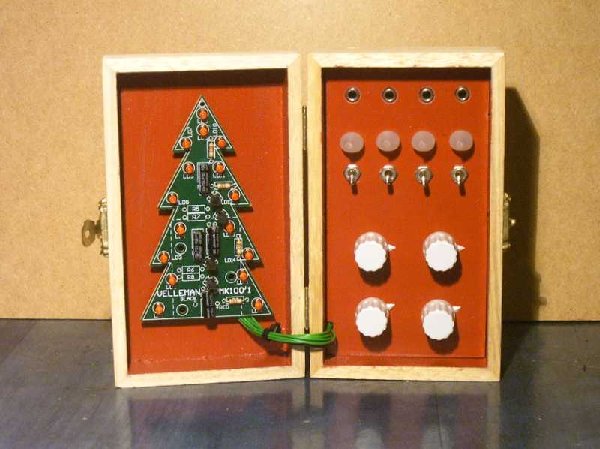

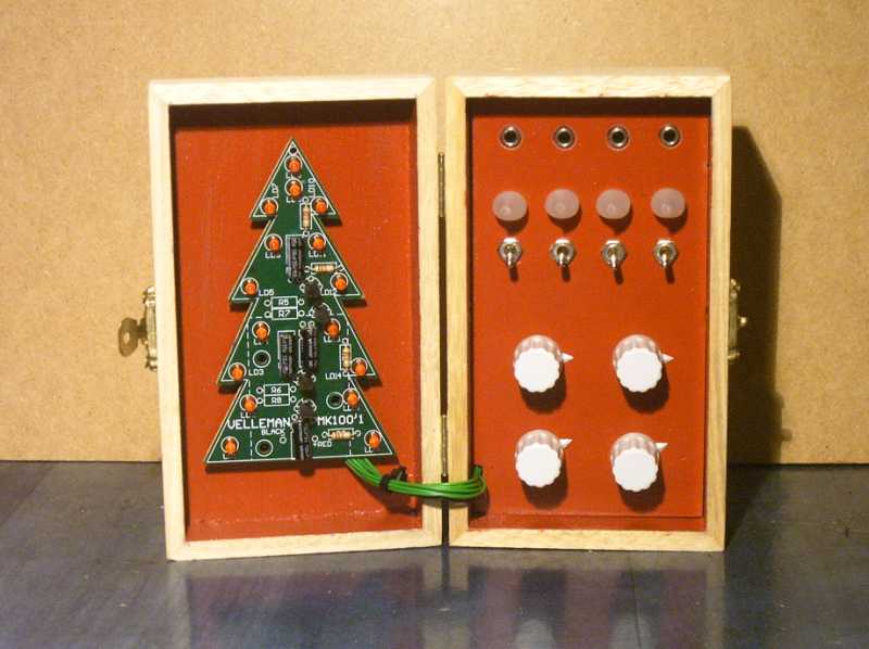

I'm trying to do a simple project each christmas (starting from last year).
And for this year I had saved myself a "christmas tree" velleman kit,
which I build and than turned into a simple sequencer called, "The Treequencer" santa
It has 2 AMV's with adjustable speed/dutycyle and the outputs of those
are fed into a binary to decimal decoder (built around a 4093) to get 4 outputs.
(more pics can be found here)

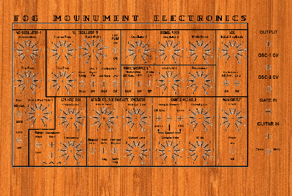

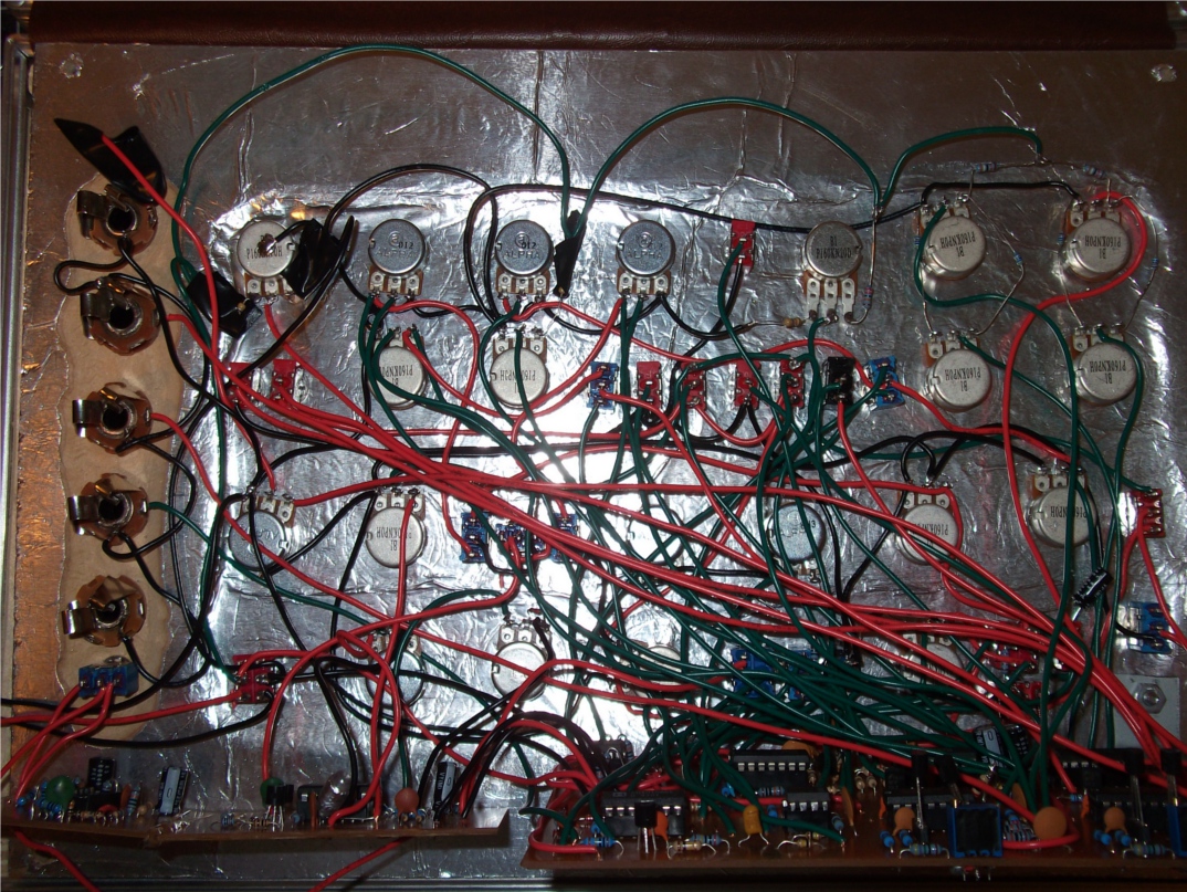

bad timing having to post after the last two fellas, but i just finished my soundlab plus and i'm pretty proud of it. excellent compliment to the MFOS 10 step seq. It's a stock SL+ with home etched boards. I also included the guitar and drum triggers which I wholly recommend. Thanks to everyone on this forum who inspired and educated me to pursue synth DIY!
A quick video too: http://www.youtube.com/watch?v=xnE5fRxKi2U
