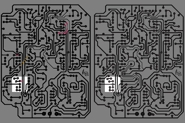

I haven't looked too close at this, but it looks like a different trace was connected rather than the one suggested. I'm not sure which is correct.

PostPosted: Fri May 28, 2010 7:23 am    Post subject: Reply with quote  Mark this post and the followings unread
It's that its not sure ,it's certain!
Am hours on circuits,and its sure its not good for the eyes.
many thanks,i fix i tright now.
EDIT: PDF IN FIRST POST IS UPDATED

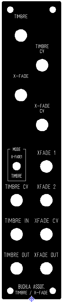

A short debug/wiring question (and verification):
- i am using R4558 and the respective resistors
- i am _currently_ using 1N4148, the 1N45 are on order.
- i build the PCB with "buchla_timbre_164.pdf", not with the recent one.
- if i apply the named kludges, e.g. 2 wires plus one +V connection, all should be fine ?
- i am NOT applying the small red dot on the lower part of the PCB
correct ?
1) Regarding wiring, do i need to connect some of the PRE Gain/Post to something (except the switch) ?
2) Audio level seems a _bit_ low ( need to crank up my VCA full to get a signal), so do i need to tweak there something? ( Resistor X?)
3) XFADE itself does not seem to work at all.
4) Literally the question stands: how to verify proper operation ?
For the curious: Panel attached.
MOTM Panel

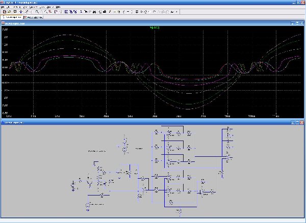

Hi Ultrashock
I used TL702's for ALL of the opamps and it worked fine -- it isn't really critical. Probably a bit of a waste using OPA's though... The FET probably doesn't need to be a J201 -- really any linear JFET will work it is more where the Vgs threshold is that is important. It is really just being used as a sort of voltage controlled resistor to attenuate the input signal. The 72K and 43K resistors are not direct values in the circuit but formed with two resistors in parallel. Don Buchla used a 49.9K//390K to get 43K -- i found that it was a lot easier to get that value using a 470K//47K as they are easier to get than the 49.9K. Ditto for 75K//1.5M using a 180K//120K.
Hi Janvanvolt
If you have the OLD PCB then you need TWO +V connections plus the other two jumpers so FOUR bits of wire/bridges in total. I still havn't got back to the XFADE section -- try putting an LED in circuit first as it gets rather expensive if you toast a VTL52!
By stepping the control voltage and feeding in a sinewave in simulated this. Which was pretty close to what I measured. The problem that you get in reality is making the control voltage adjust the amount of folding evenly. Ideally the gate of the FET should be driven by the control voltage through an opamp with gain and offset control to maximize the usable range... fairly messy to configure though...

Just to be sure (again):
- left side of "fix.png" (previous posts) is the right one, so :
1) two RED connections to V+ on the left side,
2) orange wire
3) left wire on of the upper right, as the right wire already is going thru on my PCB.
please confirm shortly.

Hi Janvanvolt
yes -- the red +V connections, the orange wire and the one left wire; i moved the existing upper-track a bit to show it could be done easily on the PCB...
