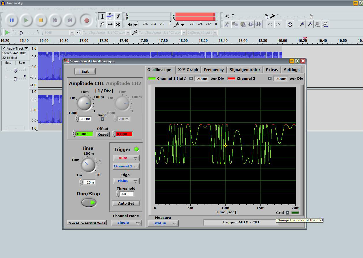

PostPosted: Fri Aug 01, 2014 4:00 am    Post subject: Reply with quote  Mark this post and the followings unread
Here's some scope shots from this VCO ,and a sample with no heavy modulations ,just to color up the triangle a bit ,guess this doesn't count for a demo for this vco , it goes thru arp vcf ,but i think it's character can be heard ,if it's trimmed right or not .. i still like the way it sounds ,thanks to Bernie Hutchins for making the design available Very Happy
