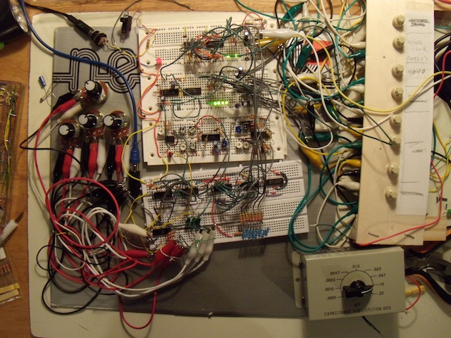

HELLO electro-music People/Lunetta-ers! I've been lurking on these forums several months, learning lots of things... I've built a couple of boxes based on 555's and 4093's, and then fell in love with the Lunetta style.
So now I am starting to mess around with more of the 40XX's, familiarizing myself with their workings whilst I decide if I want to go with a perfboard or panel design, and finding the right parts for it.
This thread was for tjookum's beginnings, but he seems to be quite the master now, so hopefully it's ok to post my beginnings here... (I didn't feel this was substantial enough for the "Let's see your Lunetta" thread.)
This is just a breadboarded "melody generator" with the 4017 & 4051 and driven by a 40106. Probably the trick of clocking the 4017's reset pin has been done, but I really like what it does.
If my attempt at embedding a video doesn't work, here's the URL : http://www.youtube.com/watch?v=Opx1ULPxcAI
EDIT: NOTE: I made a mistake in the video's text! At around 1m02s, it's actually the Disable pin (13), not the Reset pin I meant.

PostPosted: Tue Jan 25, 2011 7:15 am    Post subject: Reply with quote  Mark this post and the followings unread
Wonderful stuff! Appreciate you posting - you are getting some great sounds. See how much better you feel after sharing it with us?
Smile
Keep on!

Posts: 430
PostPosted: Wed Jan 26, 2011 4:14 pm    Post subject: Reply with quote  Mark this post and the followings unread
Thanks all.
@ tjookum : LEDs on the 4017 just seemed logical to me, since the first circuit I learned with it is the classic LED chaser. Plus, to me, the lunettas are all about the blinking lights, so I just kept them in. I'm also looking for an excuse to put in a VU or 2 that I have lying around Smile
As for my pot setup... i got tired of having them all over the place, so I quickly built that thing out of a side of a clementine box. But it's trouble in other ways... a mess of alligator clips that one has to be careful with so they don't touch and short. I'm still looking for a clean solution for breadboarding use.
Last night I fried a 40106. Maybe it was my fault... it's pretty dry in my house, but I don't know... I've had a few problems with these... then I started using 4093's instead. And then 555's. But the 4093's are easier to gate on & off, which might be handy. Hmmm, OK, back to the work table...!
- James.

PostPosted: Thu Jan 27, 2011 12:57 pm    Post subject: Reply with quote  Mark this post and the followings unread
I agree, leds are great when working with logic signals.
You're not the only one there, I've tried all kinds of trimpots and pcb pots. The models with 3 pins on one side tend to slip out really easily so now I use these:
They are Piher pt15 trimmer potentiometers with seperate plastic shaft. Cheap and they fit great on a breadboard.
A jolt of static electricity can fry an IC, try not to work on carpet or use a electrostatic wristband.
Good idea to start with the basic oscillators. Try making some drones, they will keep you busy for hours Rolling Eyes

Posts: 430
PostPosted: Thu Jan 27, 2011 5:52 pm    Post subject: Reply with quote  Mark this post and the followings unread
Interesting. Except that I tend to use a lot of pots and I don't have a lot of breadboard space. I was thinking of some kind of ribbon cable, but I can't find the right stuff in local stores.
ALSO: I apologize... there's an error in my video!... I mention about switching on a clock for the Reset pin, but it was actually the Disable pin I meant.
And I spent all evening trying to get a 4029 to count properly. I can't get it to work. Arrgh, no new sounds tonight....

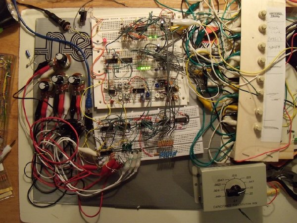

PostPosted: Tue Mar 22, 2011 3:55 am    Post subject: Reply with quote  Mark this post and the followings unread
Two recent videos. I'm still on the breadboards. However, in these videos, we don't actually see them. I modified an old CRT TV to respond to audio signals (I call it a fauxscilloscope, because it does not accurately display waveforms... e.g. a square wave isn't. but anyway, it looks cool to me).
For approx the first minute of each video, I don't touch anything, then after, I start tweaking some clock speeds.
Video 1:
WHEREIN: 4006+4077 random 4-bit generator feeds some inputs of an R/2R DAC which feeds a 555-based VCO, which is further mangled by a quad clocked 4066 which switches different caps in & out.
Video 2:
WHEREIN: Same as above, but the DAC simultaneously feeds a triple-voice 40106-based VCO, so we hear both VCOs going.
Here is a photo of the current mess/state:
 Filesize:  145.29 KB
 Viewed:  2287 Time(s)

Most excellent Very Happy ! I like the visuals too. Very lo fi-sci fi Cool .

here's a couple of things i have made recently. I've been making some simple things on stripboard for a while but I'm still wrapping my head around how to make things modular. This thread is really helpful, it's great to see people's videos with explanations about how things connect.
8 step sequencer
going to add a rotary knob to this. and I'm also wondering if I could use the leds as gates, I guess they are all pretty slow apart from the main clock.
I'm working on building a wearable lunetta, so that separate modules will be built into separate costumes and a few people play it together.
Here is 555 tone generator with a 567 ring modulator/noise maker built into a costume. I've knitted the potentiometer for the 567 - it changes restistance when stretched. There are soft buttons made with conductive fabric in the bottom scales of the mask.
I think i'm going to start making something modular by building the slacker melody generator. If you have any suggestions for modules to build i'd love to hear them.
