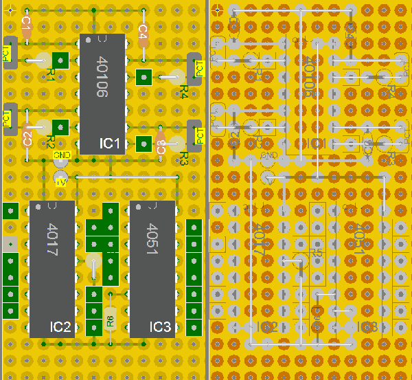

And if for some reason you too had to squeeze a melodygen + a 40106 to drive it onto a piece of veroboard 12x23 holes in size, this might be how you do it...
slacker melodygen + 40106 12x23 veroboard layout
 Filesize:  69.02 KB
 Viewed:  676 Time(s)
