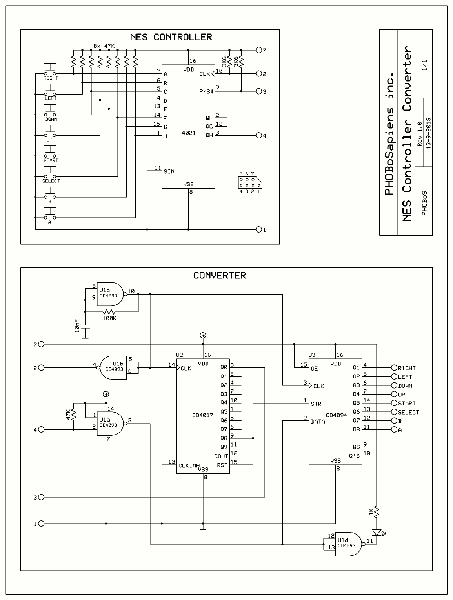

Is it possible to get single outs from each switch? Preferrably with a descrete circuit. I basicly want the switches to work like normal switches.

yes it would be possible,. you'll need another shiftregister for the ouputs and a circuit in between. I've only done it with a PIC myself (since I usually need to
process it somehow in between), but I don't see a reason why it wouldn't be possible with some logic chips. probably a CLK generator and a counter and
maybe a flipflop. (Maybe I'll try something myself one of these days)

Please do. I'm simply not clever enough to figgure it out myself. I need a schematic.
ok, here you go. Cool
I tested it with an original NES controller so it should work. U1a inverts the data so when a button is pressed the ouput goes high (instead of low).
I also added an LED that lights up and get's brighter when more buttons are pressed. You could leave it out but it's a nice indicator to see if there
is data coming from the NES controller.
Now I want to build it myself too but I need a connector. Maybe I'll get a Four Score, it has 4 connectors but it could be that it's just one piece.

You are the best! What is the output from the 4094? Trigger?
Also would it be possible to use the ABC at the same time?
If with ABC you mean more buttons, yes. you can press as many as you like. The outputs just copy the buttons, so they're high as long as a button is pressed.

Actually I meant the latch and pulse outs. I just got confused because stolenfat talked about the ABC. But that is ofcause the ABC inputs on the melody generator.
You have to extra 2 bolts on that box. Is that the latch and pulse out's? Also one has a diode, but the other one does not?
ah, I see you are refering to stolenfat's post, who uses the info from this page.
What's labeled as the 'pulse' pin is the data pin which sends out a string of bits that correspond to the buttons that are pressed. This happens in sync
with the CLK and with the values I used the CLK rate is ± 450Hz (if my calculations are correct). I first had it running at 100KHz so if it would
cause any noise it wouldn't be audible. But by reducing the speed it acts as a debounce for the buttons (at least that's the theory). So you could
use an output to control the CLK input of a counter or something like that. Anyway if you want to use the datastream as an output then you can just
grab it from pin3 of U1a.
The 'Latch', also labeled 'Strobe' is the serial/parallel control pin of the 4021. Everytime it's made high it reads the switches, which then get send
out as a string of bits over the data pin. Since it's connected to an output (pin3) of the 4017 it just sends out a constant pulse wave. The 4017 is
configured to count 8 steps so the frequency would be ± 450/8 = 56Hz.
nope, those are the powerpins (+/-), I need to get that in somewhere and I'm not using batteries inside the box.
The diode is there as a protection, just in case for if I would accidentally reverse the power. (don't want to fry the controller)
