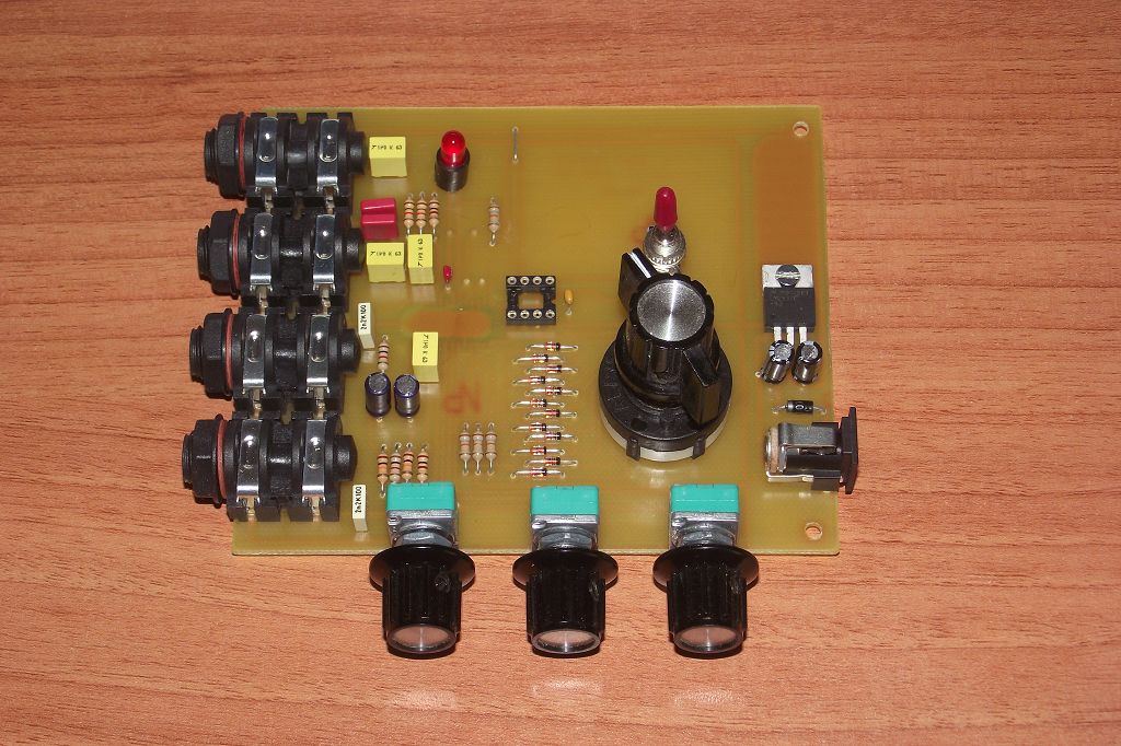

Here are two photos of my prototype.
SMD component side
 Filesize:  175.61 KB
 Viewed:  1062 Time(s)
Thru-hole component side
 Filesize:  187.3 KB
 Viewed:  946 Time(s)
Yves

Hey Yves,
Great to see the pictures of your boards! I'm glad to know that my code is getting a workout. The FV-1 is truly a unique part and quite fun to use. I'm only now trying to implement the same kinds of algorithms on other more general purpose processors, and it's not nearly as much fun. Smile
Keep up the good work, and send me bug reports or feature ideas and I'll see about adding them.
