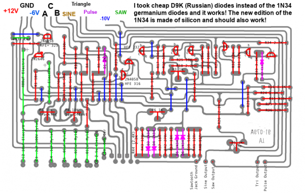

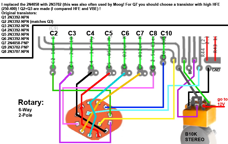

PostPosted: Thu Dec 15, 2022 5:00 am    Post subject: 901B more Information ! Reply with quote  Mark this post and the followings unread
Peake wrote:
Little kick for interest and experimenters. Note: Still unconfirmed. Use the Moog Modular Service Manual for reference and to answer any parts values/layout questions. This version is slightly different than the version in the Service Manual.
Many thanks to "Peake" who published the layout in 2007!
I checked the layout with the schematic and built it, everything works, great VCO!
I added some information to the layout !

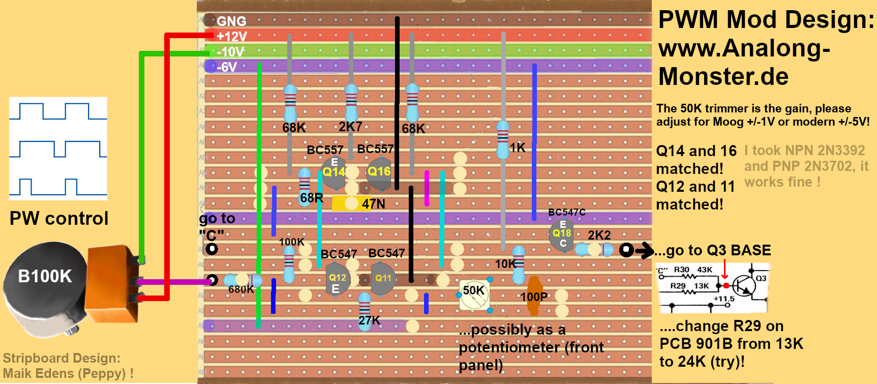

I still have a stripboard design that I created, not nicely done by me, but it serves its purpose, it's a PWM mod, you can find the original schematic on: Analog-Monster.de
Many thanks to Carsten (Analog-Monster.de) for his valuable work adding a PWM to the Square!

PostPosted: Mon Dec 26, 2022 2:07 pm    Post subject: 901a Reply with quote  Mark this post and the followings unread
What I would like to mention is an experience! Many have problems scaling the VCO to more than 2 or 3 octaves, me too! I've tried many things and often managed to give the vco good tracking on 3 octaves, over 4 octaves was hardly / not at all possible for me!
I reduced my R18 (3.3M) to 491K resistance, then it worked VERY WELL to scale the VCO to 5 octaves. VERY IMPORTANT: Let the VCO warm up for 60 minutes and no less and then start to get the octave tracking right!
Due to the reduction of R18 (901A) from 3.3M to 491K, I have not experienced any other negative effects!
PWM note: Here R29 should be changed from 13K to for example 24K, I kept this resistor with 13K and the PWM still works well!
PWM is an incredible gain for the VCO !
