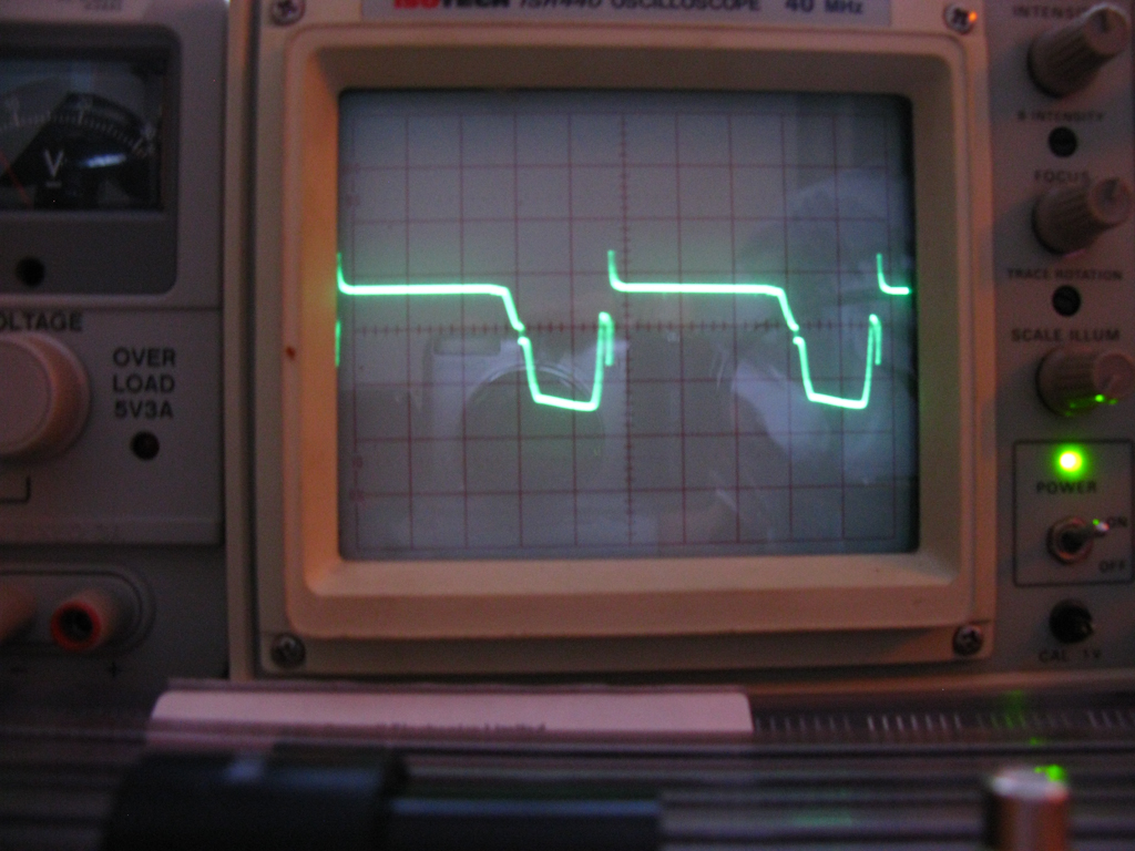

Yesterday I noticed the Drumstation channel on my mixing console was lit up, so I raised the gain to hear a loud buzz coming from the unit. I looked up to see the two 7-segment LEDs fully lit up (displaying 8.8.). None of the other LEDs were lit.
The sound is a pure square wave at the master outputs, and the left portion of the waveform is slightly ramped (dampened sounding square wave) on some of the individual outputs. The headphone output appears to be a square wave with some small noise artefacts. All at 101Hz.
The Novation PSU-4 power supply seems to be working; I'm getting 11.05V (Unloaded) and 7.2V (Loaded).
The 7805 regulator is outputting +6.47V at pin 1, and +3.42V at pin 3.

| Quote: | | The 7805 regulator is outputting +6.47V at pin 1, and +3.42V at pin 3. |
+6.47v at pin1 should be fine
+3.42v at pin 3 is definitely wrong
thats the regulated output and should be very close to 5v
within five to 10 milli volts anyway
would suggest removing the supply output to the main board and
checking the voltage at the reg 7805 pin 3 again but with a small
dummy load in place say a LED with a 2.4K resistor
if its still only around 3.4 v then chances are its the reg thats faulty
however i would also check any electrolytics nearby of
also possibly failing as well |

without a cct its difficult
something is pulling too much current
check for anything that is a little too warm
if that does not find it
if the ic's are socketed try pulling all the ic's if you can and check the supply voltage
if that sorts the reg supply
put them back in one at a time checking the voltage after each one
it may narrow it down to an area to check
| Quote: | | The sound is a pure square wave at the master outputs, and the left portion of the waveform is slightly ramped (dampened sounding square wave) on some of the individual outputs. The headphone output appears to be a square wave with some small noise artefacts. All at 101Hz. |
does the square wave appear on all of the individual outputs or only some ? if only on some, which ones ?
maybe something common between certain individual sounds
the master and headphone cicuitry i think can be discounted for the moment as less likely area's to be at fault _________________ In an infinite universe one might very well

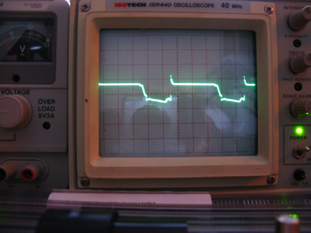

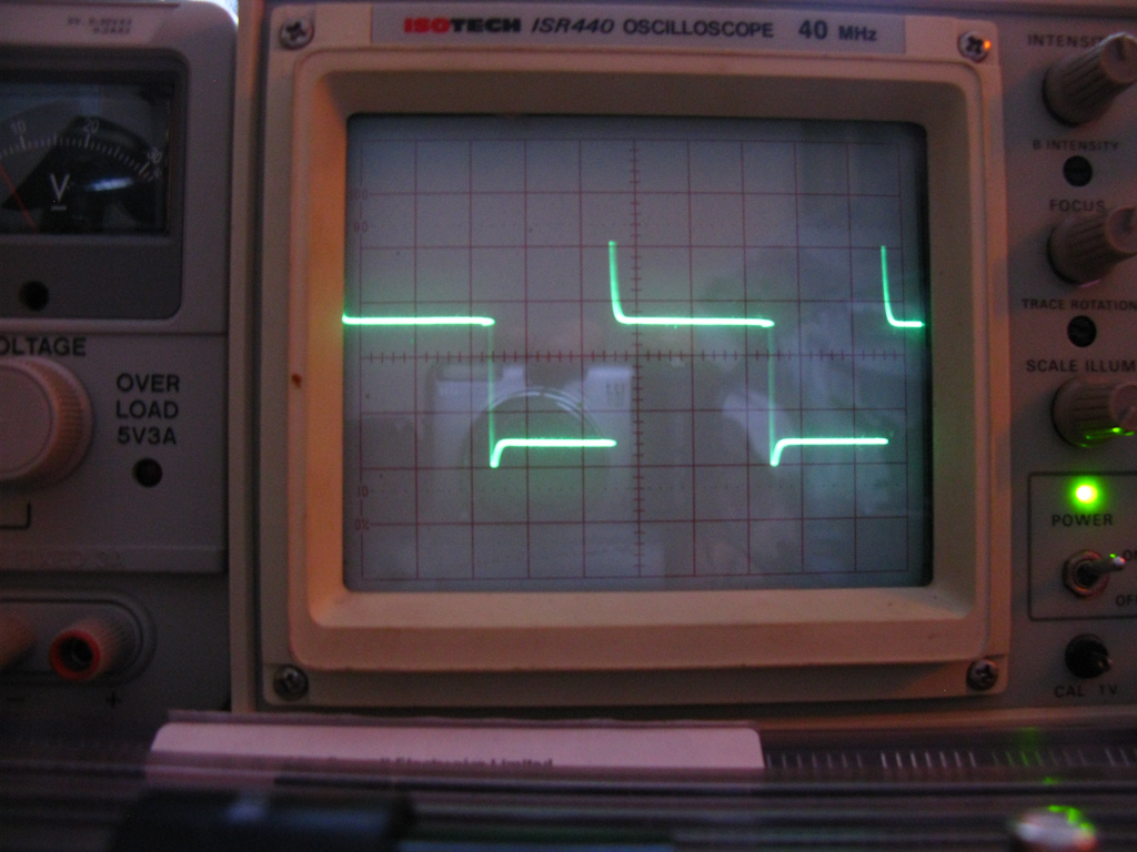

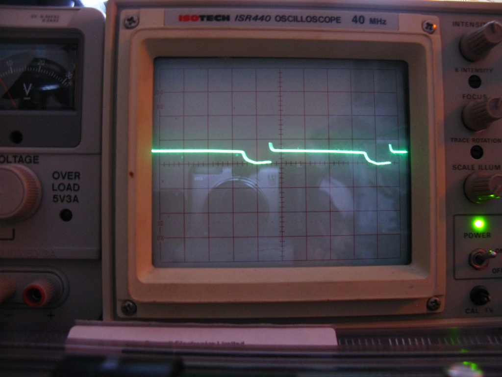

| Quote: | | Quote: | | The sound is a pure square wave at the master outputs, and the left portion of the waveform is slightly ramped (dampened sounding square wave) on some of the individual outputs. The headphone output appears to be a square wave with some small noise artefacts. All at 101Hz. |
the master and headphone cicuitry i think can be discounted for the moment as less likely area's to be at fault |
The 'square wave' (see pics) is the same across every output, doubled in voltage at the master out, and doubled again at the headphone out.
Each power up produces a different waveform (*Note the DC offset between the master and individuals at powerup 1). Occasionally no sound happens at any of the outs except at the headphones. Sometimes the display & LEDs light up differently too, changes happen per power up.

| Quote: | | Not sure what a 'cct' is, I did look online for acronyms but couldn't find anything relative to electronics (unless the Christian Council of Tanzania are able to help out). |
sorry my bad vernacular
actually meant a schematic
| Quote: | | The 'square wave' (see pics) is the same across every output, doubled in voltage at the master out, and doubled again at the headphone out. |
yeah the headphone outs will undoubtable have a fair bit of gain
wouldnt have expected the masters to be double the individual though
but it is common to all channels so thats something.
| Quote: | | (*Note the DC offset between the master and individuals at powerup 1 |
there will be a summing opamp stage somewhere there to mix the individuals possibly a TL0xx series chip but i dont know for sure what they may have used. the headphone circuitry will be tapped off the master
through another opamp something like an lm386
you are going to need a schematic i think
someone out there will have one. _________________ In an infinite universe one might very well

I just discovered my bench supply was not wired correctly (I've just moved house, and in the process of resettling). Once I got the PSU rewired, I powered the unit up off the bench and it worked. So it was then time to go inside the wart... Turned out to be a burnt out bridge rectifier. I replaced the rectifier and put a more sturdy cap in for good measure (2200µF in place of the 1000µF).

| Quote: | | Turned out to be a burnt out bridge rectifier. |
ha seems i was over thinking things again
glad to hear you got it running
