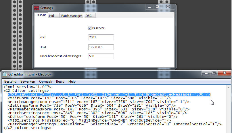

On startup I get a windows socket error: cannot bind to more that one....
I am on windows XP and get the message for both version (.49 and .60) of lib-usb.
Any hints?>
brunov
Joined: Aug 03, 2011
Posts: 227
Location: delft
PostPosted: Thu Mar 29, 2012 10:10 pm    Post subject: Reply with quote  Mark this post and the followings unread
Could be that the default port (2501) for tcp-ip is already in use on your computer.
You could have a look at the G2_editor_ini.xml in notepad. I use that file to load the "Application settings" on startup.
So you could try to change the port to another setting. "Is server" should also be on, in the ini file that should have the value "-1".
Hope that helps...
 Filesize:  106.33 KB
 Viewed:  287 Time(s)
sitarman
Joined: Jul 08, 2007
Posts: 20
Location: New Lenox Il.
PostPosted: Fri Mar 30, 2012 8:17 am    Post subject: Reply with quote  Mark this post and the followings unread
Yes it did , thanks
