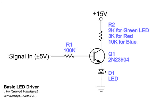

PostPosted: Sat Sep 28, 2013 3:23 am    Post subject: Reply with quote  Mark this post and the followings unread
this is the led scheme i have from you..
i guess i need to put it at the output, the "problem" is there is not only one output, maybe use a 4pos rotary switch and from there to the led scheme?

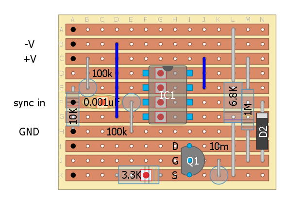

PostPosted: Sat Aug 23, 2014 5:51 am    Post subject: Reply with quote  Mark this post and the followings unread
hi there, just got round to trying a layout on stripboard for the sync, wondering if anyone cares to check it,
note: the 6.8k would go to a switch/jumper for v+ or v-
also as was asked, can the diode be subbed (1n4148?)
thanks.
