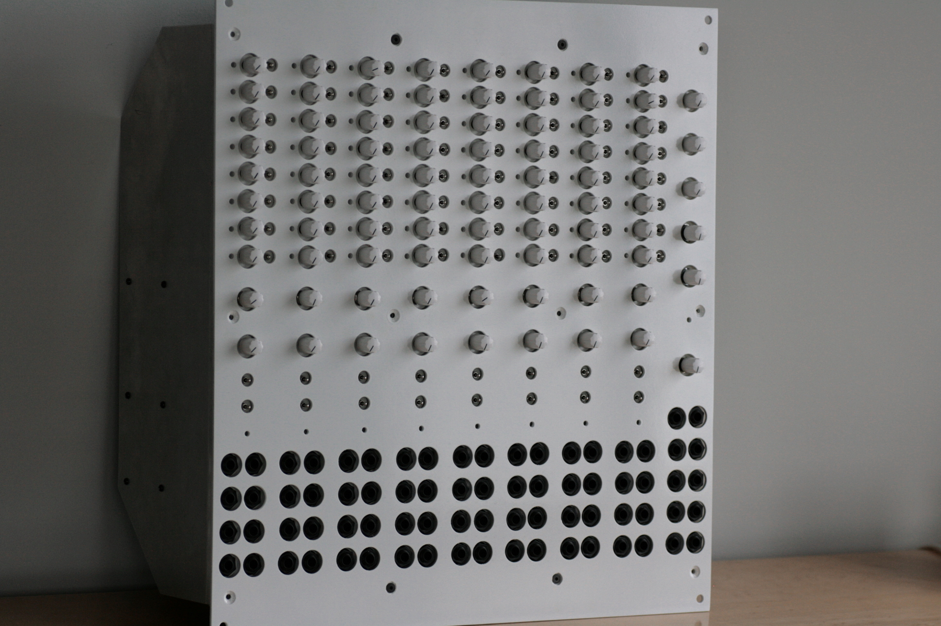

here i run two symplSEQs together with a seqswitch switching the clock between the sequencers to create a 16-step sequence. the odd thing is that it does not work with the internal clock yet. will have to figure it out... meanwhile i use an external clock.
CVs get summes and control a 4046 VCO via a simple quantizer (boogdish). the gates of one sequencer control the cutoff of a SEM style VCF:
Wiring all finished finally
panel marking and testing to go
going to try out lazertran jet and spray laquer
over the top , will see how that goes.
couple of pics
no time to commence testing now gotta go earn some money

Amazing job, diablojoy... you bring a whole new meaning to "symple"
ah gee thanks guys !
survived last night no heart attack though i thought i would throw up at one point hauling multicores across the arena floor
insane, oh hell yes, have been officially for last 20 years anyway.
you can never have enough ridiculousnessness-ness
I hope it will end up being like a classic lamborgini stupid , ridiculous , crazy but beautifull so thanks for that one matthias
now its just gotta work _________________ In an infinite universe one might very well
