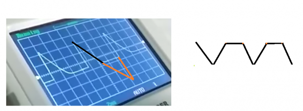

PostPosted: Wed Mar 20, 2019 3:38 am    Post subject: Reply with quote  Mark this post and the followings unread
I built the first schematic from this topic and it works great with a lm358!
Only thing is that when I connect the 'narrow' pulse to a vca it gets almost mute... when connected direct to speaker it's same volume as the saw one.

The quality is not my main interest at the moment... just want the oscillator sending saw, triangle and square waves... if its possible of course
I made the video showing all scopes.
My power supply is 9V 1A (lots of people already told me to go into dual suply, and I will, it's just for this project I'm doing all from 9V).
It should be good having variable pulse widht!!!

ok,
it looks like the half of the saw is missing,
so if you would try it to convert it in a triangle it would look somehow like this
may the transistor buffer does something strange?
for that, can you make a scope-pic:
when you are removing the connection from the 100n integration-cap to the transistor-base, and the probe is then measuring on the integration-cap
