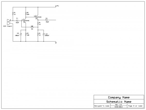

PostPosted: Sun Apr 08, 2012 6:19 am    Post subject: Reply with quote  Mark this post and the followings unread
Hey everyone,
I'm just having a go at posting a schem.
Which I just re-learned how to draw.
It's only the condenser pre-amp section.

PostPosted: Sun Apr 08, 2012 6:20 am    Post subject: Reply with quote  Mark this post and the followings unread
Okay, I should have cropped the .jpg Embarassed
But that's cool, I'll get there! Laughing

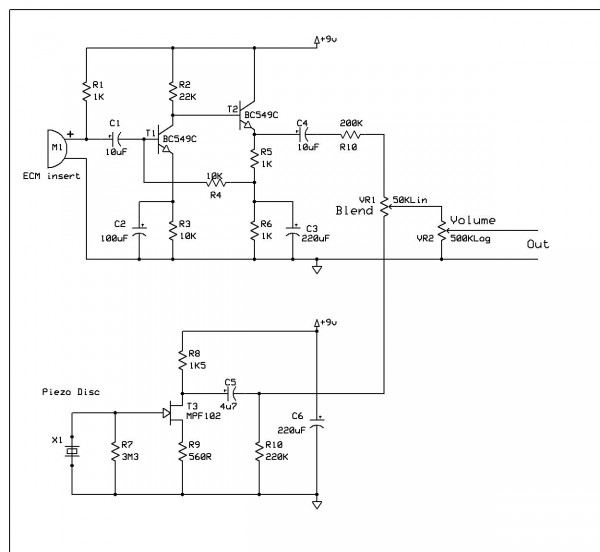

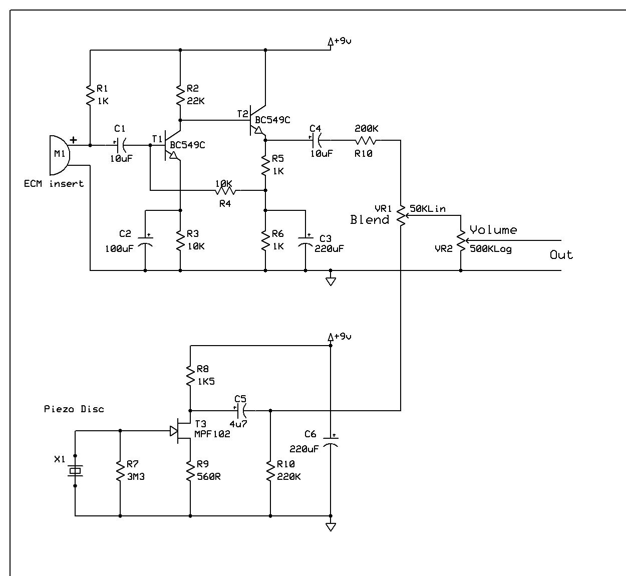

PostPosted: Mon Apr 09, 2012 4:56 am    Post subject: Reply with quote  Mark this post and the followings unread
Here's the schem of what's on the stripboard built and tested.
The condenser side was dead before because of an unsoldered emitter on T1!
Now both pickups are working quite well. I need to start testing how well it would fit into the actual harp, and what it sounds like in there, but I'm also wondering if there are any improvements to the circuit that anyone can think of.
Any advice, as usual, would be most welcome.

PostPosted: Mon Apr 09, 2012 7:39 pm    Post subject: Reply with quote  Mark this post and the followings unread
Uncle, looks like that piezo disc symbol is shorted out - delete the wire across it. I would consider adding an opamp circuit for phase adjust, though I do not know of one off the top of my head. You'll want to tap the circuits prior to their dc blocking capacitors for that one (directly at the transistor terminals).

PostPosted: Tue Apr 10, 2012 2:29 am    Post subject: Reply with quote  Mark this post and the followings unread
Before we go down that path,.....
Look at the two R10s(!?)
See the way one comes after the cap and goes to ground with the output from the junction between the two, the other one (like you advised) is just a series resistor off the cap. Shouldn't they both be the same? I'm thinking one would tend to shunt the blend pot to ground, whereas the other will behave differently.
PostPosted: Tue Apr 10, 2012 2:34 am    Post subject: Reply with quote  Mark this post and the followings unread
BTW, yeah, you're right Les, there were actually 2! shorts across that piezo. Doesn't really matter for drawing, but would muck up the netlist if this got PCBed.

PostPosted: Tue Apr 10, 2012 2:46 am    Post subject: Reply with quote  Mark this post and the followings unread
OK, uncle krunkus, let's back up a minute. When you said the piezo circuit had an output impedance of 220k was that based upon the fact that you saw a 220k resistor at the output? Because that is not the output impedance. To me, that circuit appears to have an output impedance of less than 1k, as determined by the pullup resistor on the transistor primarily.
The output impedance of a circuit is not the resistance that you see shunted at the output. The purpose of that shunt 220k resistor is to center the output signal about ground since it appears after the dc blocking cap.
The output impedance of a circuit is determined by first measuring the open circuit voltage (or simulating or calculating or estimating it), and then determining the short circuit current. Then Rth = Voc / Isc.
However often you can "look into" the circuit and determine it's output impedance from experience or with simple techniques that are good approximations. In this case I have done this by seeing that a 1k resustor pulls the signal up and a transistor pulls it down (which will be of similar strength to the 1k resistor due to biasing) for an output impedance of about 500 Ohms (1k||1k).
Now that I think about it, why on earth would a circuit have such a high output impedance of 220k anyway? I failed to do a reality check.
My advice therefore, in this circuit, is to REMOVE THE 200K RESISTOR and probably the 220k resistor as well.
The circuit should work fine then. I apologize for not catching this the first time I saw the schematic yesterday (or thenabouts). Good question krunky uncle, you identified a major problem that was cause by your mistake and my blind acceptance of it. Hang in there, we'll get this harp a'workin'!

PostPosted: Tue Apr 10, 2012 2:51 am    Post subject: Reply with quote  Mark this post and the followings unread
About putting a cap across the 560 ohm resistor, that resistor is there to set the gain of the transistor by biasing it, using a technique called source degeneration, if I recall my grad circuits class correctly. I never really got into transistor circuit design all that much (well, some), so I don't know about a cap across it but I can tell you what a cap across it would do.
It would short out the source degeneration resistor (say that ten times fast, lol) at higher frequencies, increasing the AC transistor gain while still keeping the DC biasing correct. I would think this would be an improvement to the circuit and would offer higher gain of the signal that you want to amplify. So yeah, I'd say you heard right.

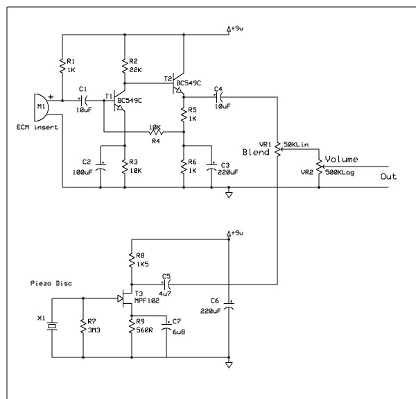

PostPosted: Thu Apr 12, 2012 3:32 am    Post subject: Reply with quote  Mark this post and the followings unread
I've modded the design to this schematic, which loses the 200K and 220K resistors, and adds a 6u8 around the 560R resistor.
It is sounding heaps louder, now I have to check it in the instrument.

PostPosted: Fri Apr 13, 2012 4:36 am    Post subject: Reply with quote  Mark this post and the followings unread
I tested the prototype this arvo, in and around the actual harp, while Mark was playing it. My gut reaction is that the condenser is picking up too much,as it often will distort even just next to the sounding hole, I may have to crank it's gain back somehow.
The other thing I realised is that the 50Klin I used for the blend is now way too big. As the output impedances of the two pre-amps have dropped to about 2K, there is a section in the middle of the 50Klin pot which is quite dead. Each end features the two pickups quite well, so I think I should bring it down to say 5K or 10K depending on what I've got.
Otherwise, we were quite impressed with the "live" sound coming out of the reference speakers.
Mark left me one of the harps, and the prototype is getting mounted in there ASAP. This will be heaps better as a test bed, and will give me the chance to record some playing and analyse what the pickups are actually picking up.

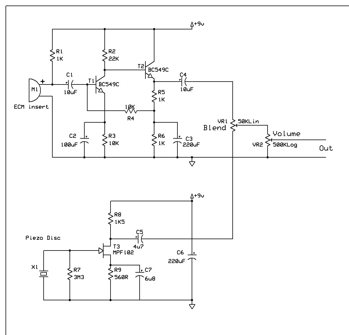

PostPosted: Tue Apr 17, 2012 6:31 am    Post subject: Reply with quote  Mark this post and the followings unread
I replaced the blend pot with a 25KLin, and that has improved the overall sound heaps, both in volume and quality.
It seems like the condenser is quite loud by comparison now, but I need to check that in the harp. The vibrations into the piezo could be a lot more than I get from tapping the desk. Anyway, we'll see.

PostPosted: Mon Apr 23, 2012 3:34 am    Post subject: Reply with quote  Mark this post and the followings unread
No, the condenser mic is still way too loud. I'm wondering if the ECM itself just can't handle the levels in there. Even with the gain turned right down on the mixer, I can't get rid of the distortion coming through, and if I do get close, the piezo can't be heard at all. Sad
So,...
Could I reduce the levels coming out of the ECM by upping the resistor that supplies it's DC? Kinda starving the little amp inside the ECM? Or should I try lowering the negative feedback resistor? Or do I just pad it with a series resistor to the blend pot? (I think this will just produce a smaller, yet still distorted, signal.)

PostPosted: Mon Apr 23, 2012 7:48 am    Post subject: Reply with quote  Mark this post and the followings unread
Uncle Krunkus, remember that we added that big cap across R9 to increase the AC gain. If I understand you correctly, now the gain is too large, so just reduce the cap. Maybe a lot.

PostPosted: Tue Apr 24, 2012 4:51 am    Post subject: Reply with quote  Mark this post and the followings unread
Ty. As you decrease the cap, remember that it will affect the phase shift which will greatly change the time domain waveform of the notes, however I recall that the Human ear cannot distinguish the phase of harmonics, so all is good the waves will sound the same.
The only difference would be a change in sound if, say, you were to put a distortion box on the harp or something. You're not insane enough to put a distortion box on a harp are you? Of course you are!
