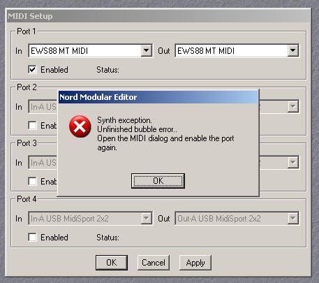

Hi All,
Whilst loading patches into my NM Classic I get the stangest error.
Something to do with "Unfinished Bubbles"?!
Even though unfinished bubbles do sound quite nice, I am left wondering whats going on...
Does this have any meaning or have Clavia left some silly developers comments in the classic editor...? Smile
Im not at home right now to replicate this error but basically it happens when trying to load patches into the NM.
Thanks in advance for any help,
Ben
<edit>
To prove that im not completly mad! I have replicated the error. After a time the editor loses contact with the synth.
On reconnection within the MIDI setup this error occurs -- see attachment.
Possibly I have a leak in my MIDI cable? I Think that parts of the bubbles are leaking out before they get to the synth therefore causing this error... Very Happy
Will contact Clavia on this some point soon... this has me really curious now!
</edit>
Parts of the bubbles are going missing somewhere...

PostPosted: Wed Feb 23, 2005 12:11 pm    Post subject: Reply with quote  Mark this post and the followings unread
I don't know, I use dots sometimes to indicate that an error is very odd and really should not have occured in the face of a user.
My wild guess is that it's a flash related error in the synth ..
Only Clavia can tell.
Maybe try to downgrade the synth OS and then upgrade it again to 3.03. This will probably rearrange all data in the flash.
Jan.

PostPosted: Wed Feb 23, 2005 1:06 pm    Post subject: Reply with quote  Mark this post and the followings unread
Yeah I do something similar with alerts / validation messages but usually put something completly random like unfinished bubbles.
On the second attempt to dump an earlier OS into the modular. First time failed so fingers crossed for this one!
Also have contacted Clavia on the meaning and hopefully a possible solution to this error.
I cant help thinking that this losing conectivity with the editor and related weirdness happend when I tried to store the currently loaded patches as start up patches. But the current error is very new!
Ill post the findings when they arrive in my inbox.

Hello,
i have exactly the same problem here under WinXP. I've tried to reinstall the OS but it didn't help. I run the editor in Win98 Compatibly mode. The midi interface is a Delta 1010. The problem occurs randomly on patch load. Sometimes the patch loads, then i got a connection loss. If I restart the editor i got this message and the synth stops playing.
