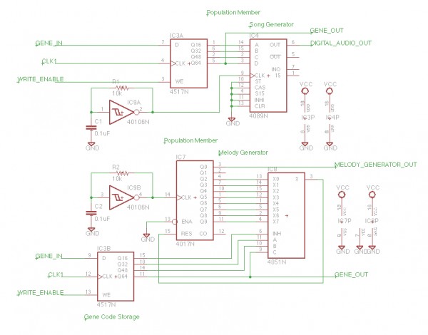

OK I added a melody generator to the mix, and made it be a population member also. You know, if you cascade those 4089's you can make a multiplier. then put that into a melody generator to make a divider. then you have AxB/C. plus you can cascade the 4089's to make an adder so you can have (A+B)/C if you want. or maybe just the ratio of A/B would be good. I'll wire that up as well perhaps.
Les

I combined the two song circuits into one. This requires twice the gene code storage but that's only one chip, for a total of four chips. That fits on one small breadboard, so I'm happy. Just a breadboard per population member for a four-member prototype, looks good. Plus one breadboard for the random generator and one for mating and audio out means only six breadboards required for the prototype, sounds good to me!
Les

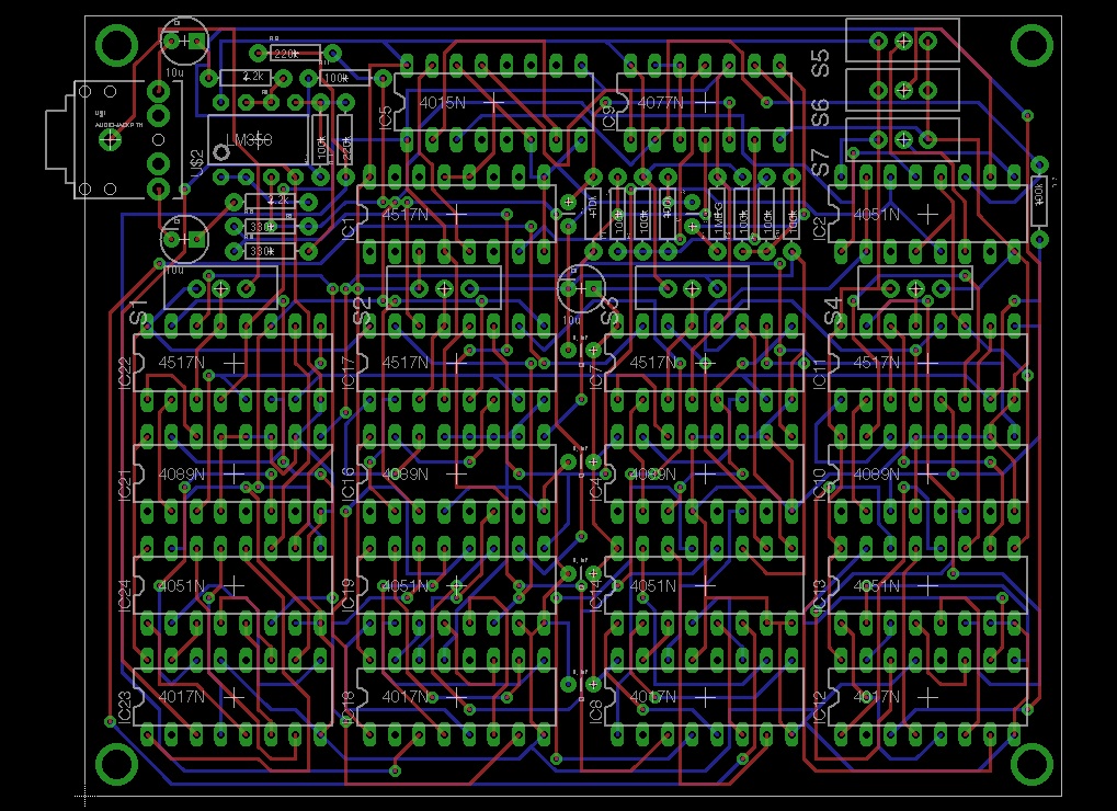

Well I somehow managed to consume the better part of two 2-liter bottles of soda since yesterday around 1pm. It's 4am the next day now and I'm buzzing like a hummingbird, lol. Plus I slept like a baby for almost 24 hours prior to that so I'm rested. Therefore: huge design effort! I took photos too.
First: the results! Below are two images, the schematic and the pcb of the completed design. At this point the only thing that worries me is the debunking of the switches, but I believe they will operate properly without debunking, believe it or not! Maybe that's wishful thinking...
Les
The PCB. I can't believe it auto routed fully, wow that's nice!

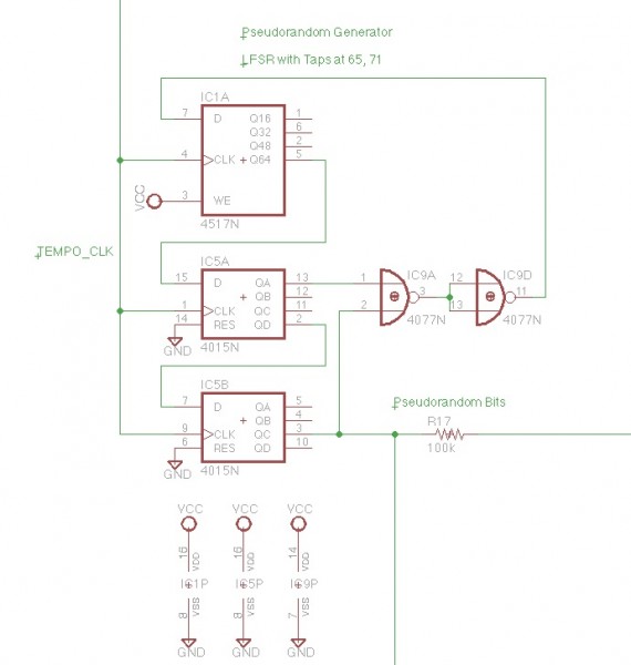

The population circuit (#3) was posted earlier so I won't repost it.
The LFSR circuit is shown below, it is a 71 stage shift register with taps at 71 and 65. It's only a three chip implementation, which is really only 2.5 chips because the other two XNOR gates are used for the two clock oscillators, shown below as well.
The oscillators are modeled after the Relaxation Oscillator that one normally uses an opamp or comparator to construct. If you think about how the relaxation oscillator works and how similar an XNOR gate is to an opamp or comparator, then you see how these oscillators work. We need one a tempo rate and another at audio rate.
Les
P.S. the resistor at the output of the LFSR is a little mixing trick that I will explain in the next post.

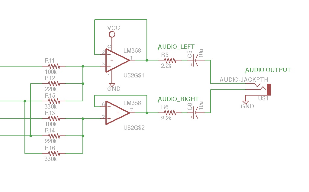

This circuit produces a stereo output of our square wavy voices with the four population member songs spatialized to left, left-of-center, right-of-center, and right channels. The spatialization is approximated by the use of resistor values that are unequal. After that are voltage followers and the standard RC network for sending out a line or headphone or modular synthesizer signal. The opamp chosen is the LM358 which is available at Sparkfun.com and can drive a 25mA load so it will drive low impedance headphones properly.
Les

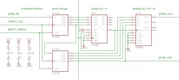

I added SRFF debunking on the write enable switches and fixed the reproduction circuit, then the board was so packed it wouldn't autoroute. So I looked for simplifications and I think I found one. The melody generator is two chips, yet it only accomplishes divide by 2 to 9, programmable. I thought: "Aren't there chips that do that?", sure enough in the CD family we have the CD4526 programmable divide by N counter, where 1 < N < 16.
I put it before the CD4089 chip as shown in the following diagram. I hope I hooked it up correctly, you tell me.
Les
Maybe. You may want to "square up" that output before it goes to the clock on the 4089.

Good find, thanks!

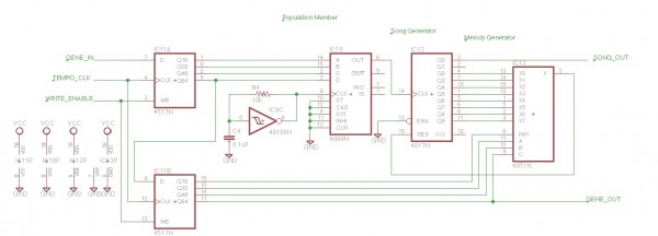

OK I added some toggle flip flops to solve the problem that jcintheus found and that earns a mention on the schematic! Smile
Attached is a pdf file of the schematic for your review. Thanks for taking a look at it, I think it's done now.
Les
