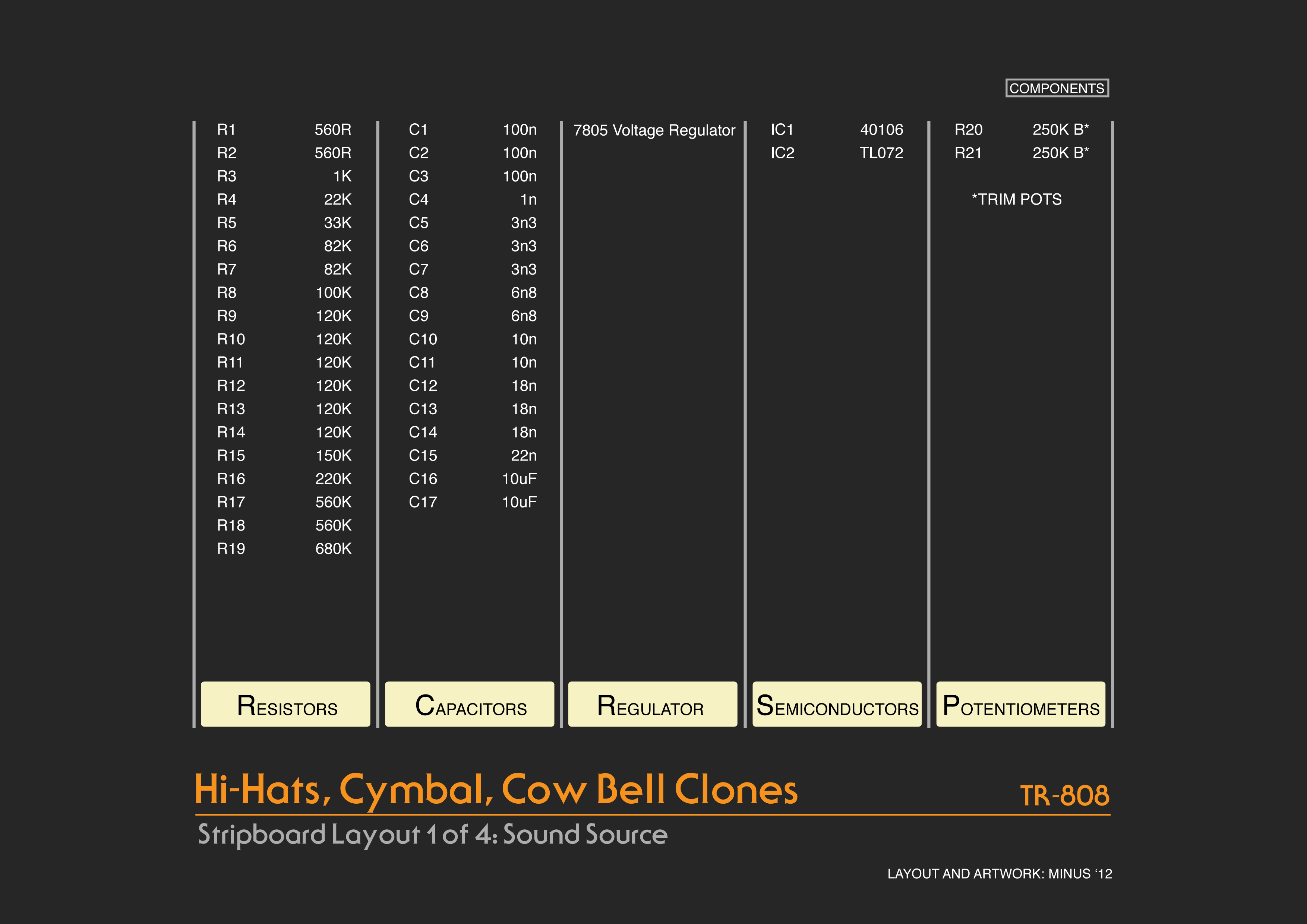

We already hijacked the I'm making TR-808 Voice Boards thread, but this has gone past the pcb's, I figured I should start a separate topic.
Using the original schematics found in the TR-808 Service Notes, I've successfully bread boarded the hi-hats, cymbal and cow bell circuits. The next stage is laying them out for stripboard.
As this is a fairly large project I have divided it up into four separate parts, each built on its own board. This means if you just want to make the hats, you will need to only build the sound source and hi-hat boards. (The cymbal, open and closed hi-hats, and the cow bell all share the same sound source.)
At present I have a completed working stripboard of the sound source. This comprises of six oscillators based upon the 40106 IC, and the two band pass filters utilising the TL072. It's a fairly dense board- I like to pack the components into a small footprint. I've used MKT capacitors because they fit in neatly. You could use green caps if you wish.
The cow bell component of this circuit uses only two of the oscillators and each are tuned with the trim pots. Cow bell tuning A needs to be tuned to a frequency of 1.85 ms, cow bell tuning B at a frequency of 1.25 ms. It is worth noting that to achieve this range I had to change R15 from 150K to 100K, and R8 from 100K to 68K. You may need to change this too. You will need an oscilloscope to correctly tune the oscillators regardless of whether you intend constructing the cow bell or not. These two oscillators are used for the hi-hats and cymbal despite the fact they do not enter the band pass filters en route to the cow bell board. I have also found that to my ears, the tuning sounds better at different frequencies to the ones specified by the men in white coats at Roland Corp. You may want to experiment with this. More about this later....
I'm drawing up the rest of the boards now and will post them here as I test and confirm the layouts first. If I think of any details I have omitted, I'll post updates here.
Happy stripboarding!

Here's the next instalment, the cymbal. I tried a few times to get the footprint down in size, but after a build failure I decided to be less cluttered. My previous effort took the electricity around the scenic route! This version is now built and working and comes out about the size of a playing card. There are a lot of traces to be cut so be careful. If you build this exactly as is, it should work as mine does. Incidentally, I'm running this off +/- 12V at present.
I'll post some sound samples and photos soon.... soon as I stop playing with it!

I've learnt a lot over the past couple of weeks (courtesy of Roland Corp) by studying these schematics and notes. I am triggering from a very crude 4017 sequencer experiment I did ages ago. It may be worth while adding something like Eric Archer's diode cap resistor configuration on the input ( I haven't), or Ken Stones gate to trigger circuit to get a nice clean trigger input. Also, I didn't mention about the Accent in. This can be tied to +V if you wish or to a pot wiper with outer legs to + and Ground. I really need to get a better sequencer built.... soon! I'll have the hi-hats and cow bell off the breadboards on onto stripboard over the next week I imagine.
Here is part 3: the hi-hat circuit. Took a couple of attempts to get this working, but it has been built and certainly works . The layout could have been condensed a little further, but I seem to run into trouble when I try to do that... and all to save a couple of rows of stripboard holes! You will need a standard 34 hole wide piece of stripboard for this one.
Please don't feel intimidated if you have never stripboarded before. I cut the board to size using a craft knife/Stanley knife/box cutter and a steel ruler. I make several cuts each side of the board and simply snap when I think the cuts are deep enough. I then mark the underside using a black marker/felt tipped/ Sharpie pen. It is imperative that the tracks are cut in EXACTLY the right place. If you get this right, you are well on the way to success.
Cutting the tracks is easy. I use a pin vice and a 3MM drill bit. I spin the pin vice about six or seven times. Just enough to cut through the copper. Don't drill through the whole board! It will only weaken it. Once all cuts are done, I check it thoroughly with a magnifying glass just to make sure.
I tend to solder the components with the lowest profile first. Keep those resistor legs you snip off- they can be used for the smaller jumper wires.
Well, that's all for now. I'll get some photo's and sound clips posted shortly. Cow Bell coming up next!

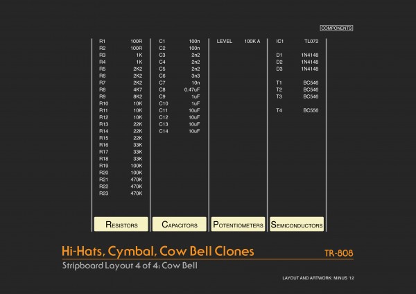

Here is the final voice... the one we've all be waiting for: The Cow Bell!
A lot simpler that the other two voices. Having built this, it actually doesn't sound that bad. I listened to real cow bells on youtube and I don't think this is that much further in sound compared to the real thing than most of the other voices are. I get the impression that cow bells in general have a bad reputation nowadays. We need to listen to these in context of the era in which they were made. It was a different aesthetic back then. Just look at the font Roland was using on the 808. The orange font I used on these diagrams. That would be seen as a joke these days. Yet Herb Lubalin was one of the greats of typography. That font was cutting edge at the time. I remember using it!
Anyway... this is the end of the line for these. I might continue with the other 808 voices at a later date. Hope some of you build these!
Sound clips will be recorded shortly.... oh... and socket those transistors!
