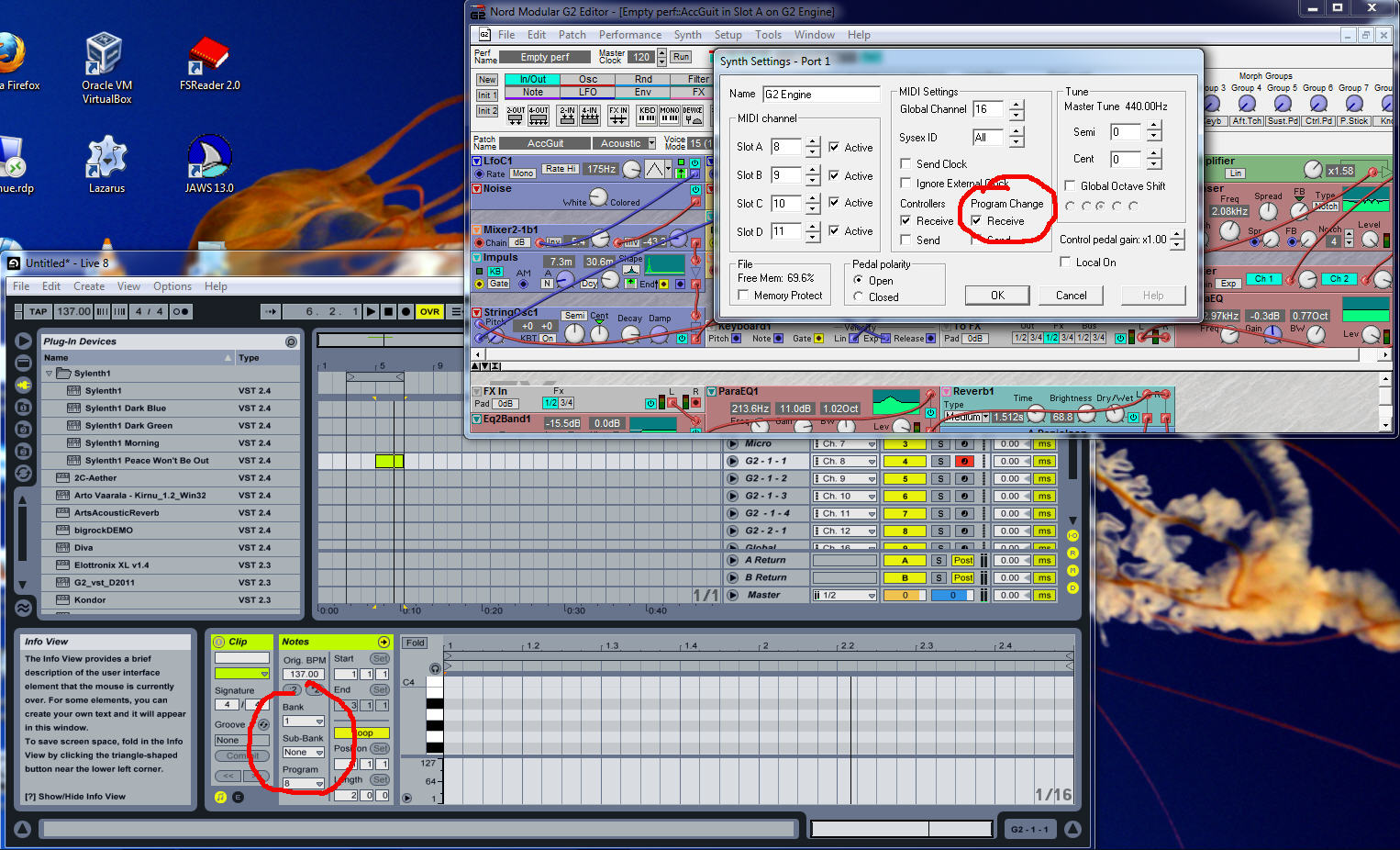

how can i make ableton change a patch (1-Cool
cheers.

Make sure Program change receive is enabled in the g2 synth settings. Then you can choose bank and program in your ableton midi clip.

cheers nice wan, but is there a way to jump to the 8 variations?
also, for some reason in ableton, when i select a clip with a program change in it, the g2 doesnt change program, only after i select the clip again does it change....?

variation change is cc70; there is a CC list in the manual BTW.

I happen to know that one too Very Happy ... Push the little E button in the midi clip, select midi ctrl 70 and draw in your variation changes
