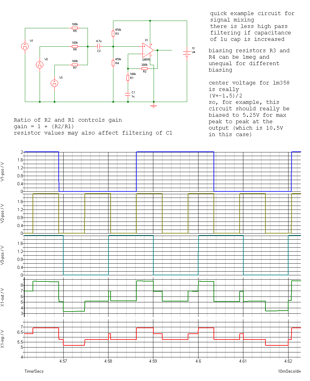

I strive to make all my circuits work from a single supply so I do a lot of biasing to V+/2. You can add biasing to your signal at the non-inverting input then a feedback network to the inverting input, with a capacitor to ground ... I better do a diagram, this will not amplify the biasing and amplify only the signal. However this introduces more high pass filtering than I like so I just adjust the biasing if it is convenient to do so.
oops, I accidentally did a simulation with graphs and everything Rolling Eyes Laughing

You're making up for lost time today Jingle Joe!
I have seen circuits like the one you've shown, but I was unsure as to how they worked exactly (hence I tended to stick to the inverting amp). I'll have to give this a try sometime. I have messed around with non-central reference voltages, usually because I wanted a set range of control voltage outputs but you need to be careful it doesn't swing too far one way or the other (and flatten out). Also, some op-amps work better than others, depending on the max/min voltage outputs it can produce (i.e. the output swing voltages).
As an aside, what software did you use to produce the schematic & simulation and does it cost any money? I can afford reasonably cheap software, but I prefer free!

JingleJoe
Joined: Nov 10, 2011
Posts: 878
Location: Lancashire, England
PostPosted: Thu Nov 29, 2012 12:07 pm    Post subject: Reply with quote  Mark this post and the followings unread
Thanks,
Gary
lucky for you I can't afford anything because i have no money ... shit! internet bills Surprised
Anyways, Simetrix is what it's called, it was highly recommended by an old electronic engineer i knew Smile
I can see why too, it;s free and brilliant and the diagrams are industry standard.
It might be called simplis now but they are both the same really, there is a paid version which simulates larger circuits but I only encountered that problem when I was making a circuit with about 5 op amps in it. I just simulated them separately and bob is your uncle, it worked fine Smile
