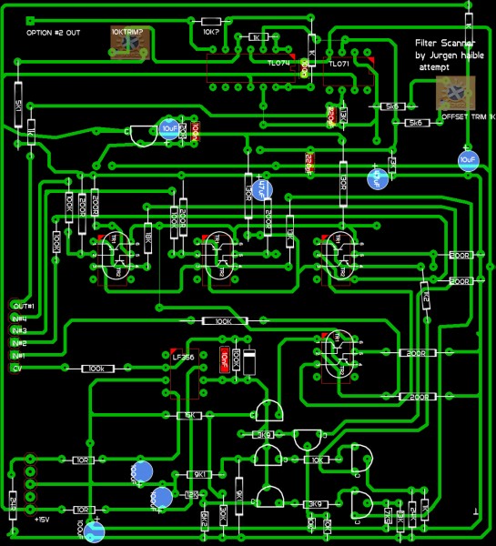

PostPosted: Fri May 20, 2016 1:18 am    Post subject: Reply with quote  Mark this post and the followings unread
here's an attempt for that Jurgen's scanner , i have no way to proto - this ,and test things so i just layout the board with two variations for output , one is with TL071 and is ,or can be identical to the output of the big interpolating scanner from Jurgen , the other option using TL074 which i kind of hope might work is simpler without offset trimpot and is borrowed from a version of Moog VCF ,all this is untested , the matched pairs are BCM
 Filesize:  1.11 MB
 Viewed:  574 Time(s)
 Filesize:  406.37 KB
 Viewed:  442 Time(s)
