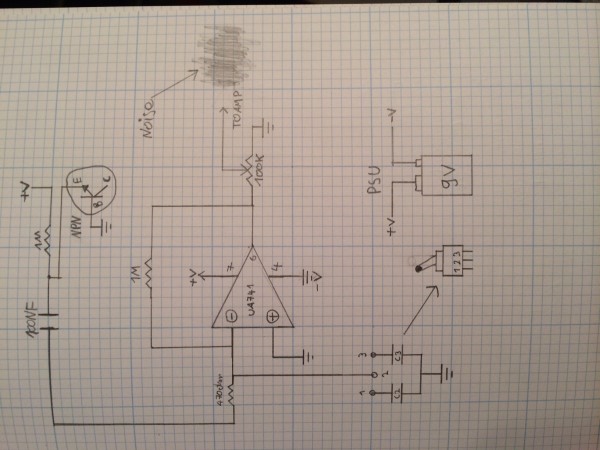

To make the video of the breadboard it is a very nice the idea!
May I ask why you didn't connect the op-amp's non inverting input to ground? _________________ electronic-sea.net |

Thank you guys
one blemishes but it makes no audible difference.
yes! i used the UA741 veteran tested also with lm324 tl072 tl07X.
I think every singel opamp works!
15 v not tested but i think it works also

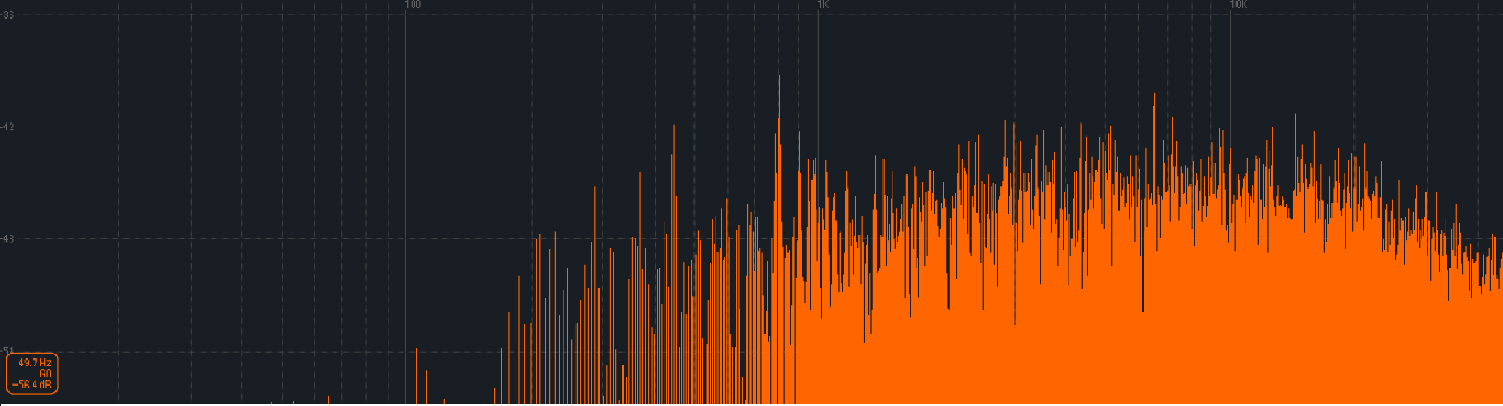

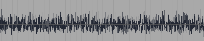

Posted: Thu Apr 04, 2013 3:23 pm Post subject:
Nice! Thanks for posting the response charts. _________________ JacobWatters.com |

Posted: Mon Feb 03, 2014 9:33 am Post subject:
Darn it, I can't make it work! |
I can make most things work, given time, but this - despite its elegant simplicity - has me stumped.
I have used all-new parts, tested them all (the 741 by substitution) and double-checked connections. I have tried it on a speaker, a 386 op-amp, a small but very sensitive amp I use for other projects, and earphones and I get nothing, nada.
If there was one component I should try varying a value for, which would you suggest? |

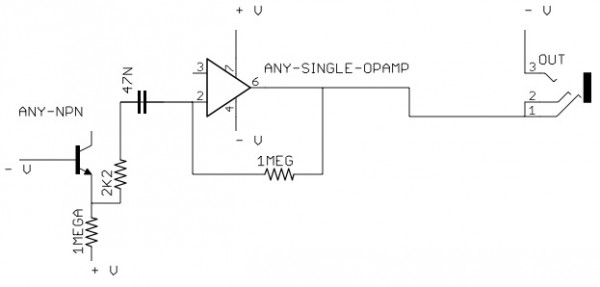

One thing though - you have + (pin 3 on a 741) on the op-amp going to ground on that diagram...
Your drawing of a PP3 also shows reversed polarity... Last edited by beesontoast on Tue Feb 04, 2014 5:00 am; edited 1 time in total |

I can make some pretty weird noises by coupling it to a 386 op-amp and ignoring pin 3 as per the original circuit - something like a cow with bellyache attacking a duck...
But nothing remotely like white noise.
Oh - I also made a pretty fair EMF detector by putting a coil and a 100nf in series between pins 2 and 3. |

I tried a PN2222, BC517 and currently BC547B. |

I have solved the problem I had with the first circuit by adding in a potentiometer, and it turns out with a resistance of about 240 ohms I get white noise in a single 16 ohm earpiece.
(added) It turns out that a small electrolytic in that position also does the job. |

In place of the 1M resistor. It does seem to be important to use a 12v supply - 9v does not work. |

hi everybody , ive managed to build this white noise generator , and ive tried to pass it through an amplifier build out of opmaps as well . but when inputing to the opamp i get nothing , im building a device for my sister , cause my niece wont fall asleep if she doesnt listens to white noise ( LOL) do yo have any input on whats going wrong ive read that opamps cant amplify a white noise but havent figured out why . thanks for the great info. will apreciate some help.
pd: im triying to build a standalone 1 watt speaker circuit amplifier circuit and input the white noise |

there are two schematics here,
one is using a dual power supply, which seems to work
the second seems to have problems, i guess because of the missing virtual ground
which oneyou are using?
which kind of power source do you use? |
