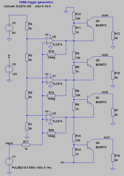

elektrouwe
Joined: May 27, 2012
Posts: 149
PostPosted: Sun May 12, 2013 10:05 am    Post subject: Reply with quote  Mark this post and the followings unread
cablebob wrote:
I thought dot mode would only output at one pin without overlap ??
obviously it's a feature of the LM3914 which is not useful for sequencers.
Why not use a simple & cheap "discrete" solution ( I hate single source special purpose ICs ) . 2 quad.opamps or comparators, 8 PNPs and a handful Rs will do the job. My circuit simulation shows 4 steps, but 16 steps with 4 quad opamps will also work. For LFO frequencies a LM324 would be ok, for audio frequencies a faster opamp or even comparator (LM339) makes sense.
quad trigger circuit, non overlapping outputs
 Filesize:  42.8 KB
 Viewed:  179 Time(s)

PostPosted: Sun May 12, 2013 11:35 am    Post subject: Reply with quote  Mark this post and the followings unread
my intention was a voltage quantizer, for sequencer I'm happy with 4017.
If other pins output a voltage while inactive, I could live with it, if the voltage, which is unintentionally added, would be constant all the time.
would be the same like a small DC offset.
