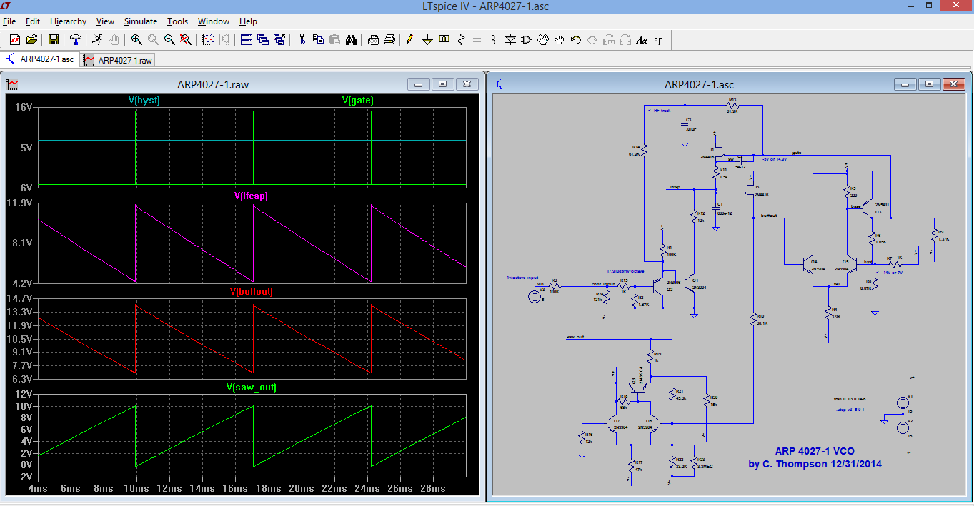

koenpepping wrote:
first of all thanks for sharing the vco Smile
I was looking at the BOM and noticed the ST3P switch.
my question is:
what does it do? and where can i find one?
thanks again and already!
It switches the frequency range between audio and LFO. See LF-SWITCH-A,B and C in the schematic.
Pole A changes the frequency CV, pole B switches in another capacitor at what I'm guessing is the core integrator (A and B both result in lower frequency) and pole C switches in a trimmer for the triangle shaper (presumably to improve the triangle shape in LFO mode).
I don't know what sources you have available to you but Mouser seems to have plenty of 3PST switches to choose from. You could also use a 3PDT if that's easier to find, just leave one throw unconnected.

PostPosted: Wed Dec 31, 2014 1:16 pm    Post subject: ARP 4027-1 LTSpice simulations
Subject description: Simulating the 4027-1 oscillator
I just put together a 4027-1 VCO simulation in LTSpice. Works good but I did notice that any JFETs will work as long at their VTo is larger than about -2 volts. I also incluced the HF track feedback circuit (as annotated).
See attached schematic and simulation waveforms. This is a good way to see firsthand what waveforms should look like before you build the actual circuit.
