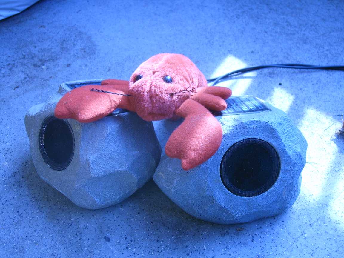

So for some time I had been thinking of making some new mics that are solar powered/charged which I can leave outside. So when I need them I
just plug the cable in (inside) and I'm ready to go. We had some nice sunny weather a few weeks back and I used it to fix some of my solar
powered LED lights, checking which worked, replacing some batteries etc. I also have some lights in the shape of a rock and while I was looking at
them I got the idea of using those for the microphones.

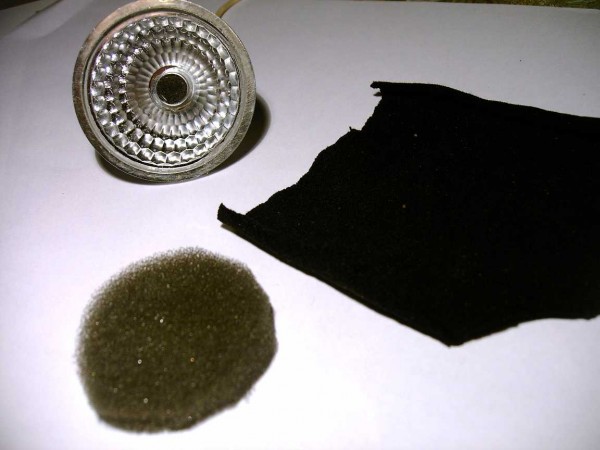

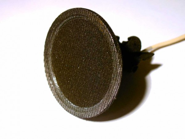

The LED's are placed inside of a reflector so I removed the LEDs and glued in some electret mics instead. I then cut some pieces of foam to act
as a windscreen and covered them with a piece of nylon stocking, tied together at the back with a cabletie. This should protect the mics against
dirt and to some degree rain.

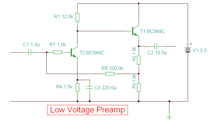

I then searched the web for a simple low voltage transistor preamp and found this schematic here
note: I added an extra resistor to power the electret mics

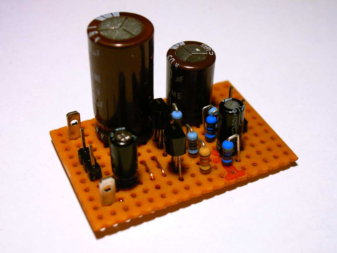

I tested it on breadboard and it worked quite well, so I build two of them on perfboard and hotglued them on top of the battery compartments.
I drilled a small hole in each rock for the audiocables, which are soldered directly to the PCB, and used 3mm neoprene LED supports to make it
waterproof.

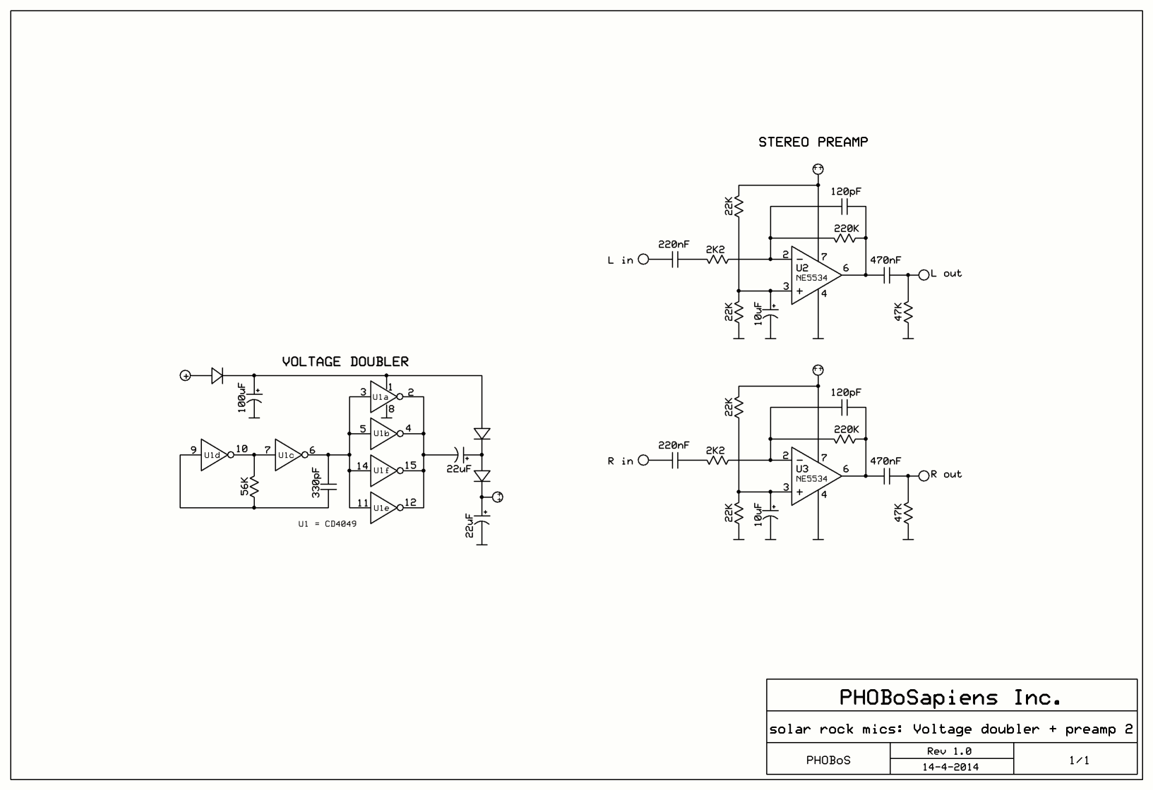

I already made an extra preamp with some low noise NE5534 opamps so I don't have to add so much extra gain on my mixer and it also filters the
subsound out and some of the high frequency noise. I will post a schematic of that later but I want to put it in a box first.

ok here's the schematic. I added a voltage doubler to get plenty of headroom which runs at a high (inaudable) frequency. I'll probably just put
it in a small box that I keep inside powered by a wallwart but maybe I make it solar powered aswell. sunny

I tried to figure out what the problem was. My first idea was that it might be caused by difference in hfe of the used transistors. (can be twice as
high for the BC549C). Although from what I understand of the schematic the feedback resistor should take care of that to some degree. So I
desoldered the transistors and measured the hfe of those (and the rest of the BC549C's I coud find) and taped them to a piece of paper with the
value written on the tape. The closest values I found were 691-693 and 685-688.
so for one mic I used hfe T1 = 685, hfe T2 = 691
and for the other one hfe T1 = 688, hfe T2 = 693
That didn't really help, although I got the idea that now the other one was louder but that must have been a mistake. So I started measuring
voltages; supply voltage was roughly the same for both, but then I measured the voltages over the electret mics, and I got 1.5V for on mic
(the loud one) and almost nothing for the other one. Turned out that I used a 47K resistor instead of a 4.7K to power the electret mic doh
I replaced it and the levels are a lot more equal now Very Happy.
