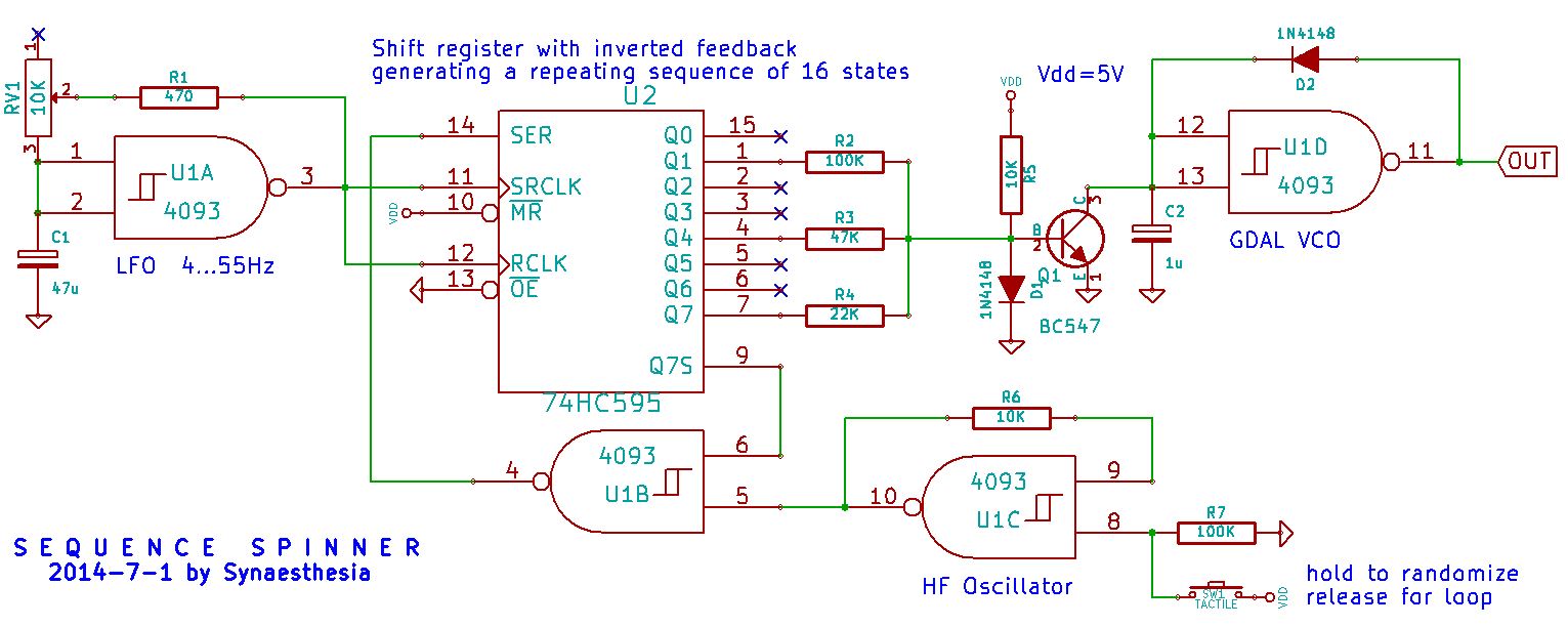

PostPosted: Fri Jul 04, 2014 11:41 am    Post subject: Sequencer Spinner Reply with quote  Mark this post and the followings unread
Here is a variant of the WOF circuit. This time the circuit is meant to repeat a sequence of 16 notes. The sequence can be randomized by pressing a button. When the button is open, the last bit of the bit pattern through the shift register is inverted and fed back into the shift register. That generates a sequence of 16 repeating states. When the button is pressed, a random bit is inserted in the shift register instead.
Each note in the sequence is derived by using 3 of the shift register outputs. However, the order of the notes in the sequence is never random and not all possible sequences of 16 notes will occur. I believe this is similar to the Benjolin or the Rungler.
Nevertheless, the sequences are interesting to listen to and I have added a sound file. The first 18 seconds are recorded with one repeating sequence and the speed is increased over time. Then the randomize button is held to continuously change the generated sequence and the speed is increased again (pausing for an extra long time to listen to the nice glitch sounds at high speed that many of us enjoy).

Posts: 5939
PostPosted: Mon Jul 07, 2014 3:41 pm    Post subject: Reply with quote  Mark this post and the followings unread
love it. Very Happy
If you would replace U1b with an XOR you got a mini Turing machine.
(and if you make a discrete XOR with a bridge rectifier like here you don't need an extra chip)

PostPosted: Tue Jul 08, 2014 11:44 am    Post subject: Reply with quote  Mark this post and the followings unread
A real turing machine! Well, what an intriguing idea... if I make that shift register really, really long... I could build...
- no, must stop that thought! Been there, done that. Smile That's why I have so many TTL and CMOS chips left, waiting for a new life in lunetta circuits.
With regard to the turing machine module at the link, saw that and I like it. I chose a NAND because I wanted it to work as an inverter to double the sequence length. Of course an XOR could act as an inverter too. So not sure if it would make a big difference in this circuit.
