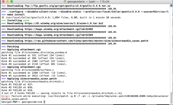

PostPosted: Mon Feb 08, 2016 7:19 pm    Post subject: New Error
Subject description: this is a new error that no one else has discussed yet.
I'm getting a failure no one else has posted about. This is the 2nd go, same failure occurs.
Any help would be appreciated.
Followed the directions exactly as posted.
I'm trying to see if this method works with the Roland XV 5050 editor. I just need WINE to recognize my MIDI board to communicate with the synth.
If I get it all working, I'll post results.

PostPosted: Tue Feb 09, 2016 1:03 am    Post subject: Reply with quote  Mark this post and the followings unread
The latest version of WineHQ already incorporates the Sysex patch, so no need to apply it. Just download WineHQ, grab the .exe, and off you go!
