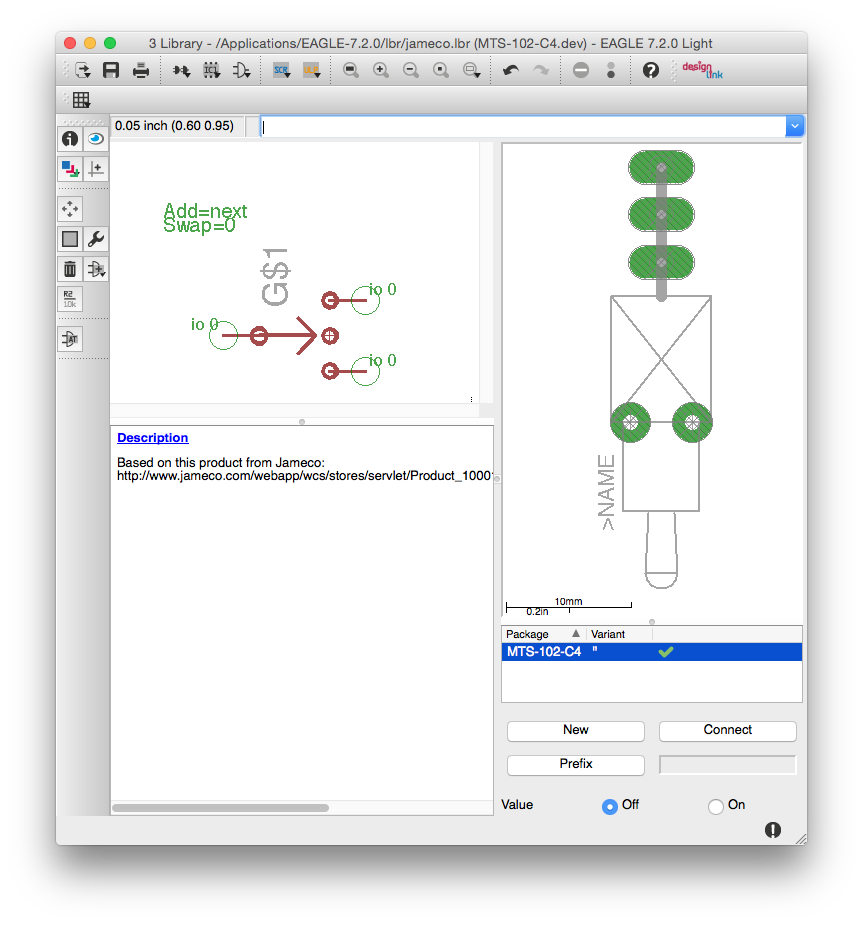

PostPosted: Thu Jan 14, 2016 7:15 pm    Post subject: Reply with quote  Mark this post and the followings unread
This will probably work for that "special buy" Jameco toggle:
Jameco Vertical Right Angle On-Off-On Toggle
 Filesize:  105.99 KB
 Viewed:  407 Time(s)

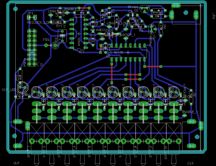

PostPosted: Sun Jan 17, 2016 12:50 pm    Post subject: Reply with quote  Mark this post and the followings unread
Here is a whack at a one-sided layout with those toggles. It was a trick to get down to six jumpers...
 Filesize:  38.88 KB
 Viewed:  414 Time(s)

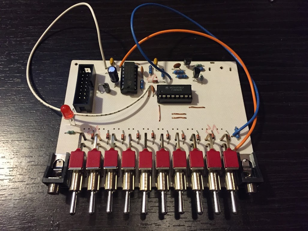

PostPosted: Sun Jan 24, 2016 6:25 pm    Post subject: Reply with quote  Mark this post and the followings unread
Works great. I like these switches quite a bit.
 Filesize:  176.91 KB
 Viewed:  395 Time(s)
Posts: 5947
PostPosted: Wed Jan 27, 2016 9:55 am    Post subject: Reply with quote  Mark this post and the followings unread
looks good! Razz
Are the jacks in line with the switches ?
PostPosted: Wed Jan 27, 2016 9:37 pm    Post subject: Reply with quote  Mark this post and the followings unread
From the look of it they're a millimeter or two off.
Any reason why the wire jumpers are left long?
Other than that, looks like a useful module Smile
piedwagtail
Joined: Apr 15, 2006
Posts: 297
Location: shoreditch
PostPosted: Thu Jan 28, 2016 1:08 am    Post subject: Reply with quote  Mark this post and the followings unread
I see the jacks as holding the pcb, the switches are threadless and would therefore poke out less. Nice idea.
but I'm confused by the output led being perpendicular which suggests a slim desktop enclosure with the unfitted step leds...except the eurorack power port is.... Smile
Internal wires I like to use screw terminals 3.81 or 5.08 to allow the pcb to be removed from a panel without having to desolder or de-attach everything. I blame Ken Stone for making me hate soldered up panels. Wink

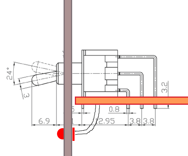

Here is an idea to minimize LED wiring and keep the board one-sided: Move the LED holes under the switch bodies. Trim the LED legs to be long but the same length. Mount the switches first, then set the long-leg LEDs into the holes from the bottom so that the switch body holds them flush with the top of the PCB. Solder the LEDs onto the bottom and bend into holes in the panel. I might try that. But this thing is pretty expensive to build with all those switches!
 Filesize:  57.95 KB
 Viewed:  417 Time(s)
piedwagtail
Posts: 297
PostPosted: Thu Jan 28, 2016 3:23 pm    Post subject: Reply with quote  Mark this post and the followings unread
If there's a problem with space under the switches, you can do away with holes and etch small pads as if the leds were SMT.
This is what I did for the first time with this design; there was too little space under the switches to have through holes and solder, so I placed a hole for one end of the 1n4148s and a pad at the other; worked fine.
Since the panel hole will hold the led body this is an option you have.
pioneering THSMT!
R
