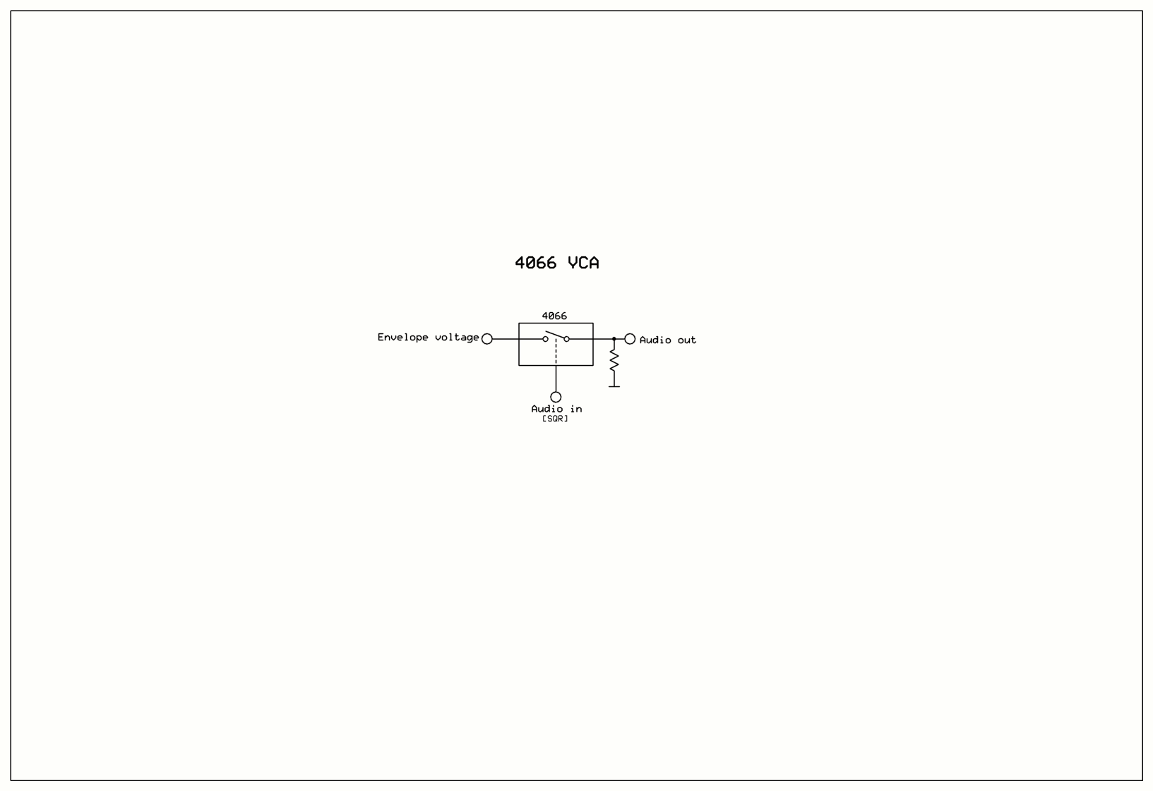

One thing that's not fully clear is how it creates the ADSR voltage. Do you want to add a DAC/resistor network to the priority encoder ?
synaesthesia wrote:
First, you need some "vent" to control the output level. A 4066 analog switch is either on or off. You cannot control what goes through it easily.
I think the idea is to use it in reverse so to speak. Instead of having the audio level controlled by the switch you're controlling
the switch with the audio. a varying voltage on the input of the switch will create the audio signal with that voltage as amplitude at the output.
It's a similar approach to using a single diode and resistor to create a VCA.

Right, didn't see the idea to run it in reverse. Wouldn't much of the signal be lost then? If you happen to have one, an example circuit for this concept would help.

Yeah, exactly the switch is controlled by the digital audio signal and the analogue output from the ADSR is what is being switched on and off which will give an amplitude to a square wave coming out of the 4066.
ok, drew one. (I'm using ExpressSCH btw)
I did see it before probably somewhere on this forum.
 Filesize:  13.65 KB
 Viewed:  499 Time(s)
