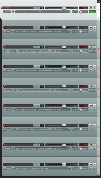

Hi Des,
I looked how to do it in reaper.
First create an instrument track with Bazille on it, set midi in to none.
Now add 8 midi tracks, set each track to the linnstrument and correct channel.
Now select all 8 midi tracks and drop them onto the Bazille track, now the midi tracks are "owned" by the Bazille track and the midi from them is automatically routed to the plugin.
Enable record monitoring on the midi tracks and off you go.
I have included an image.

Interesting bit with Reaper. I had started playing around with the same idea...just thought it would 'neater' to just have everything on one track.
