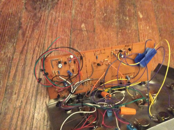

This is what I wound up doing with this project.
Really wasn't what I started out to do. But I'm really happy with it.

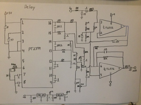

This is the pt2399 delay circuit I wound up using in it.
Here is a link to the video of the almost finished project.
Sorry the amplifier I was using was crap.
https://youtu.be/h1drX1jdUEE
 Filesize:  1.08 MB
 Viewed:  528 Time(s)

To sum it all up
It works great for such an easy project.
It takes a few minutes to warm up the vco, then it stays pretty stable. I did use a matched pair of 2n3906s and bonded them together. Not sure if it helps in this particular situation or not. That's beyond my knowledge level.
I could get about 2 octaves in tune then it fell off quick. The one octave on the bass pedals is perfect on the tuner.
The trimmers on the resistor chain volt per octave key circuit I used in the pedals need to be 10 turn. I started with single turn and got it in tune. But it was a pain, and the gate signal was so touchy to get right. The 10 turns made things a lot easier.
I increased the low pass filter capacitor values more than I ever have in the pt2399 delay circuit, and added another low pass on my input buffer.
I think it's my favorite delay circuit yet. It sounds warm and natural even at long delay times.

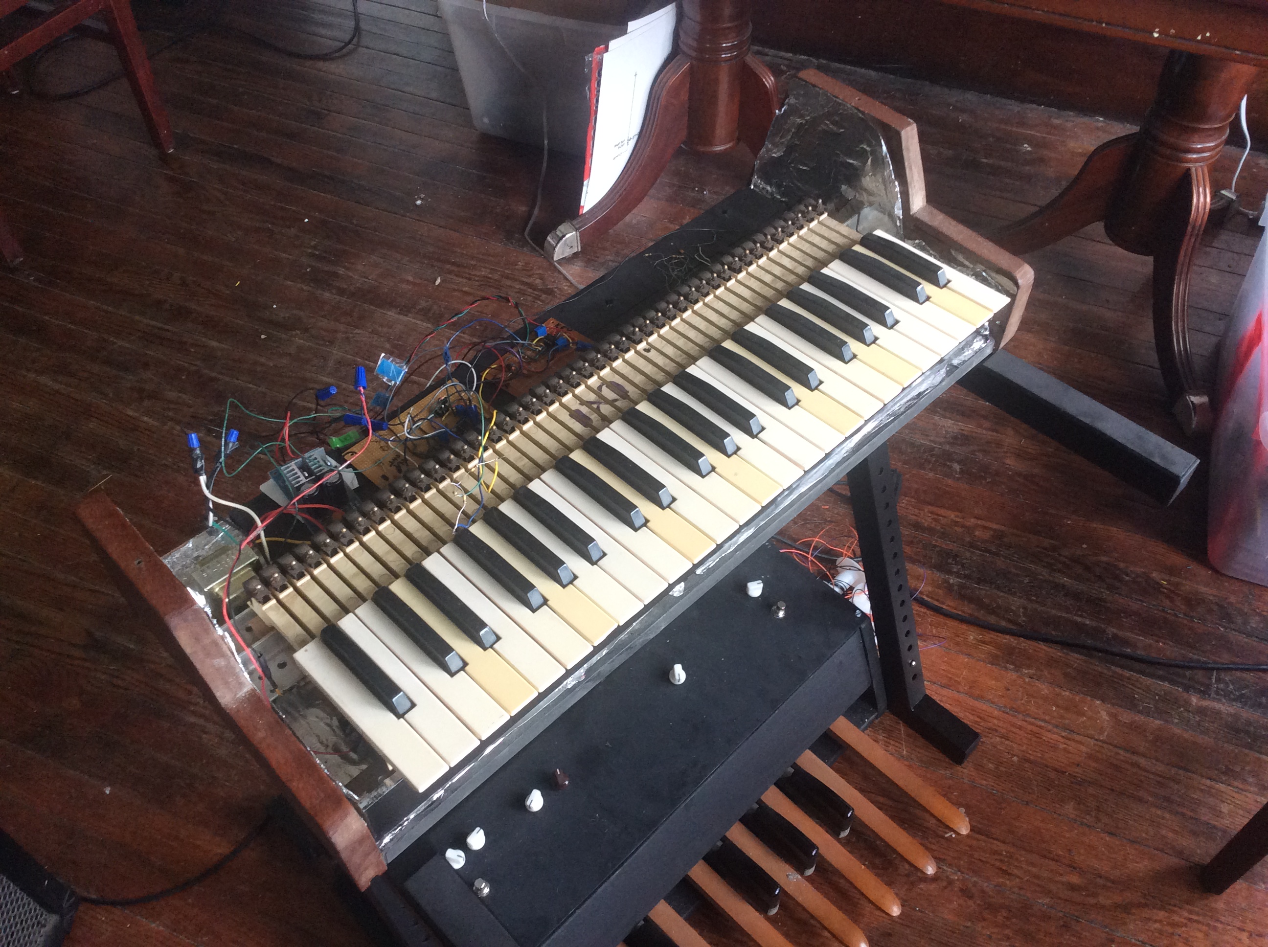

I decided to try this basic idea on a larger scale keyboard using the volt per octave schematic I used in the key pedals.
The span is drifting way to much with small temperature changes.
i ordered a bourns trimmer for the span adjustment. These cheep Chinese ones do seem to drift more with temperature. Fingers crossed
The bass pedals did not have a substantial temperature drift issue, however I was only trying to keep one octave perfect.

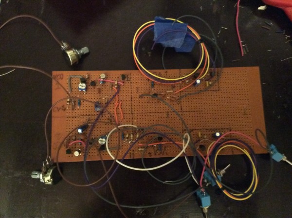

PostPosted: Mon Jan 09, 2017 5:01 pm    Post subject: Reply with quote  Mark this post and the followings unread
I have recently came back to this project and am working on a desktop synth using 2 of the VCOs and 2 of the VCAs along with 2 simple transistor envelope generators, and a simple VCF. All passive components.
Should be fun
Here is the board as it looks now. That is actually almost completely populated. So I'm thinking of throwing on a 2 channel ping pong sequencer.

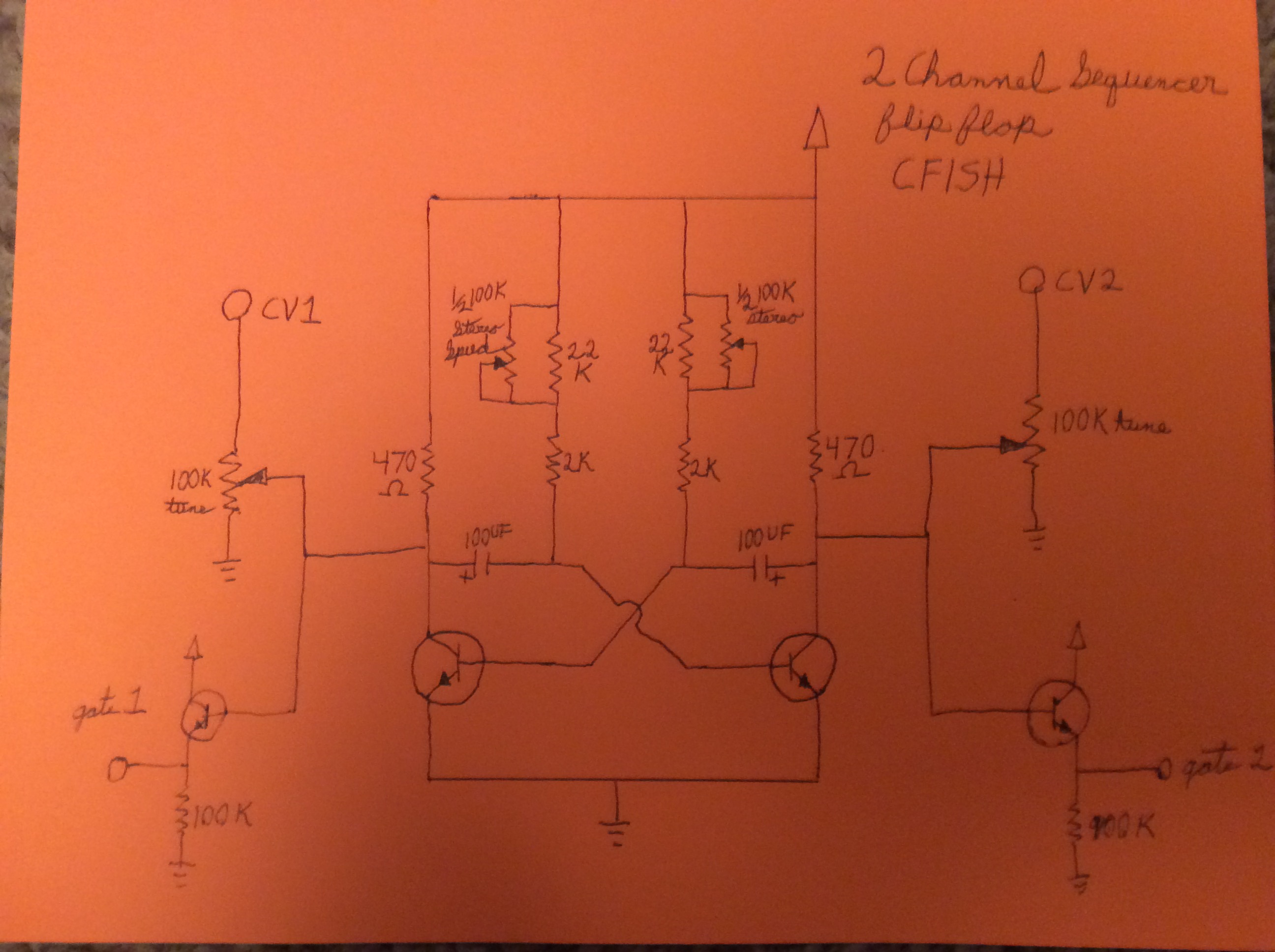

PostPosted: Tue Jan 10, 2017 5:26 am    Post subject: Reply with quote  Mark this post and the followings unread
Hi Grumble
Just something to ping pong between the 2 VCOs.
This is what I came up with.
Am trying to do this as an exercise in (getting what I can from discrete components).
Only using circuits from my memory and trying to give them good purpose.
Might do a sample and hold too.
(Edit) I just noticed something. When I was testing this circuit for values to get acceptable speed range output, I used an LED in series with each 470 ohm resistor. I forgot to make value adjustments when I removed them.

Cfish
Joined: Feb 24, 2016
Posts: 477
Location: Indiana
PostPosted: Tue Jan 10, 2017 11:46 am    Post subject: Reply with quote  Mark this post and the followings unread
Well, my memory wasn't so good.
LOL I apparently made the same mistake on both VCOs and can't seem to figure it out.
Have built that VCO schematic more than 10 times and never had it fail to work.
It should be obvious, however it's iluding me.
When I find it I'm gonna feel stupid!!!
Cfish
Posts: 477
Location: Indiana
PostPosted: Tue Jan 10, 2017 12:51 pm    Post subject: Reply with quote  Mark this post and the followings unread
Found it.
And yup, stupid. Flipped B1 and B2 on the UJTs. I kept checking that, and inverting it when I flipped the board back and forth.

PostPosted: Sun Feb 05, 2017 7:26 pm    Post subject: Reply with quote  Mark this post and the followings unread
A little on the project using this concept.
All on one board, 2 VCOs 2 VCAs plus 2 Descrete EGs I posted in another place here.
Look at that board, a child could do it.
