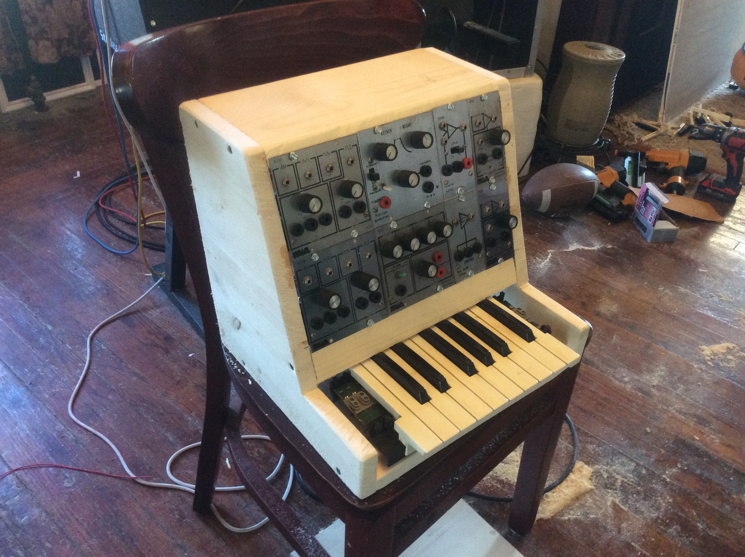

Had these PAIA 4700 series modules for a while. Finally decided to do something with them.
It's starting to come together.

Anyone happen to know what size banana jacks these are?
I need to order patch cables, and got it wrong on my first try.
RC2525
Joined: Feb 17, 2013
Posts: 5
Location: PA
PostPosted: Tue Nov 15, 2016 9:54 pm    Post subject: Reply with quote  Mark this post and the followings unread
Nicely done!
The patch cables that carry control voltages are known as pin tip jacks, essentially the same thing that is used by many multi-meters. Not really banana jacks, they are thinner and they don't stack. Most likely you will just find the tips (rather than a complete patch cable) and have to make your own patch cable. One user tried speaker pin plugs from RadioShack and they worked. You can order the pin tip jacks from Mouser.
Mouser part 530-105-0302-1
Alternatively, you could replace the pin tip jacks with banana jacks.

Thanks RC2525. Got some ordered.

I'm trying to figure out a power supply for this little system using things I already have.
I have a prebuilt +-9v regulator and and an 18 volt center tapped transformer, but it don't look like that will do.
I have a spare 30v center tapped transformer I could use and get the +-9v while making some extra heat I'm sure.
With an extra 18v regulator for the positive rail, seeing when rectified the transformer produces about 22v per rail Dc
The real question is will the 18v be to noisy?
Posts: 5895
PostPosted: Sun Nov 27, 2016 5:19 am    Post subject: Reply with quote  Mark this post and the followings unread
Is the 18V of the center tapped transformer a measured voltage or what it is labeled at ? I think you might be able to get away with using that one.
It looks like a very small system and I don't see any leds so the power consumption is probably low. Although I can 't tell without seeing the
actual circuits or even better measuring it. But with a small load the output voltage of the tranformer might be higher and even if it is 18V I don't
think it would be a problem. I wouldn't recomend it for a modular system that will be expanded in the future but for something like this I think it is
worth a try.
Cfish
Joined: Feb 24, 2016
Posts: 477
Location: Indiana
PostPosted: Sun Nov 27, 2016 7:50 am    Post subject: Reply with quote  Mark this post and the followings unread
Thanks PhoBoS
The 18v is labeled AC RMS voltage. Will se what it comes out to DC rectified later today.
the 1496 ICs in the balanced modulator VCAs are the only thing that uses the +18v and -9v rails for power.
EGs use +18 to ground and filter uses +18 to ground. But filter sounds the same using +9 to ground on my bench supply.
VCOS are +-9v rails
If the load is to high I could try running the EGs on the +9v rail to ground. That would leave the 2 1496 ICs as the only load on the +18v regulator.
Not sure how that might affect the EGs function. I have not looked at the E.G. Schematics very closely yet
