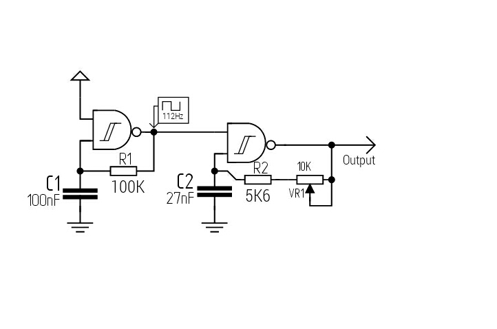

Last night when I was reading the thread about PHOBoS' Nandulator I noticed a comment that the last Nand gate oscillator prior to the output behaved more like a filter than an oscillator so I decided to do some experiments.
In the figure below The Left side oscillator is just a normal Schmitt trigger square wave oscillator, to provide a suitable test signal. The "oscillator" to the left is the filter.
With the values Shown the output is akin to a bandpass filter with high resonance and when the pot is varied it tunes in what are presumably the harmonics of the input square wave.
Other Findings.
If the input frequency is higher than that of the second oscillator ( acting as the filter ) the 2nd just tends to lock onto the input with limited variation in the sound when the 10K pot was varied.
It also works well when fed with this with white noise where again the Nand oscillator behaves a bit like a resonant filter. It needs to be heard, particularly with the noise , as it is quite a distinctive sound.

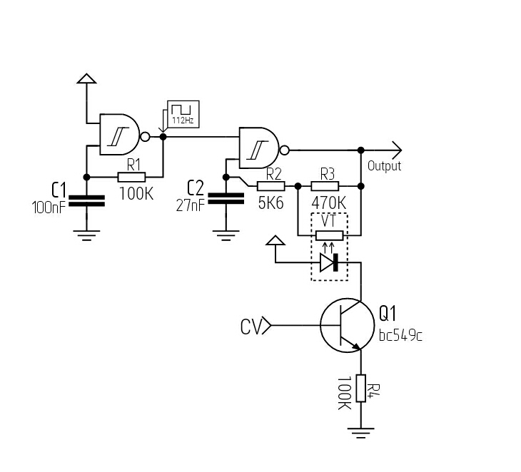

By adding a vactrol I have been able to make this into a VCF.
See below:

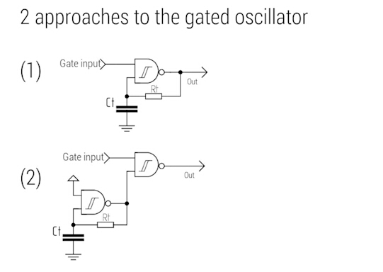

Some more thoughts on this circuit.
In the attached image the usual gated oscillator is shown as (1) when it is gated off it actually interrupts the oscillation cycle as the output is forced high for the duration that the gate input is low.
In the circuit marked (2) the gate input has no effect over the oscillation cycle but simply determines whether or not that it is passed through the 2nd gate.
In the context of the Goschillator (<<<<<are we really calling it this!!!) I would think this would actually influence the nature of how the signal input to the gate comes out at the other side. I will need to test this to see. It is too late now to do so tonight but I'll be interested to hear it for myself.

Posts: 24676
PostPosted: Mon Apr 10, 2017 1:42 am    Post subject: Reply with quote  Mark this post and the followings unread
I was wondering about that difference too .. as the original configuration would need some extra charge time (as the capacitor would end up more discharged after having been off for a while) it should produce less (very) short glitches .. probably.

PostPosted: Mon Apr 10, 2017 7:01 am    Post subject: Reply with quote  Mark this post and the followings unread
The difference in sound between the two circuits above are like night & day. The 2 gate version is more extreme and similar to ring modulation using an XOR gate. On this basis I don't think that the 2 Nand gate circuit can qualify as a goschillator!!

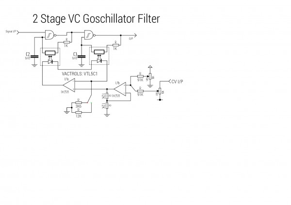

PostPosted: Fri Apr 21, 2017 12:01 pm    Post subject: Reply with quote  Mark this post and the followings unread
Today I made a 2 Stage Goschillator Filter with Voltage control using 2 VTL5C1 vactrols. I was very impressed with the sound.
The switch is to change the range of the filter, with the 3K6 resistor switched in it works better for higher frequencies and for lower frequencies it is better to switch to the 12K resistor.
Notes: Power supply is +12 V
Input & Output are digital however it could be adapted for analogue systems with some additional circuitry.
NAND gates are 4093 ( TI brand )
The reference voltage is +3 Volts attached to the bottom end of VR2. I haven't included a circuit for generating this.
Do you think that this is getting too complicated to fit into the Lunetta category?
