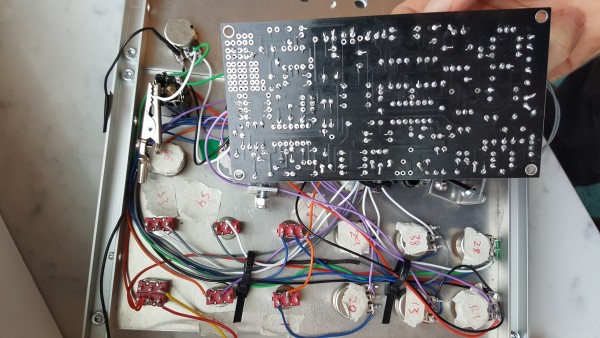

The wierd sound generator was easy to build, so I thought I'd step up to the noise toaster. Completed the build, but no toast. I'm looking for some help debugging it.
My multimeter suggests a possible culprit: the circuit's main virtual ground is off.
The ground is set by resistors 37 & 42, both 4.7K. However, my measured resistance from BP to Ground is ~1K, while from BN to ground is ~2K. As would be expected, I'm thus observing BP as 1.7V above ground, while BN is 5.3V below ground; Likewise, a number of other values as measured at the inputs to the various op-amps agree with what the book indicates they should be, except shifted by the 2:1 ratio caused by the fault in the virtual ground (this is good news, it suggests that most things are right if I can fix the ground). For example, the wiper on variable resistor R1, which controls the frequency of the VCO, should vary from -4.5V to +4.5V (to ground). On my unit, it runs from -6.57V to +1.8V.
Could someone with a working unit share what they measure for resistance and current BP-Ground and BN-Ground (so I know what the correct values are?).
I'd also love any specific suggestions as to what part(s) of the circuit are worth extra close scrutiny.
Since I expect BP-Ground resistance near 2K (hoping to check this by comparison to a working circuit, hence my post here) and observe a measured resistance of half that, I suspect a short someplace (is this reasonable? Any other ideas as to possible causes?)
This is almost certainly a "poor assembly" error. I built it from the Soundtronics kit. I worked very slowly through the build, checking each component 3 times prior to install. Likewise with the panel wiring, every wire was labeled prior to soldering and triple-checked vs the schematics. What I'm saying is all components and wiring should be correctly placed (not well installed, but at least in the correct place). You'll see from the photo that I'm not that good with a soldering iron...

I havent build the Noise Toaster yet so cant help with measurements. Sorry, but your soldering looks bad. Are you using leadfree solder? My first guess is a problem with one or more solderjoints. My suggestion to you is to go over all of the solderjoints and correct them. Watch some Youtube videos about soldering, i think this one is very helpful https://www.youtube.com/watch?v=AqvHogekDI4 .

Thanks for the reply. Yes, it is lead-free solder, yes it was a bad job. I've gone over all of the solder joins since then and reflowed them; I also clipped back the excess wires.
The board now looks much better, but the basic problem hasn't changed. I'm not saying bad soldering wouldn't have caused other problems, but it doesn't seem to be behind this one.
Also, I've gone over the wiring multiple times. Each time, everything checks out.
