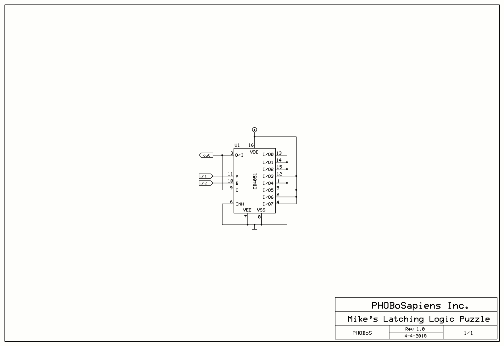

I need a 2 input, 1 output gate that does the following:
Output is low unless both inputs are high (like '&')
but stays high until BOTH inputs go low.
Some sort of flip flop or latch thing I recon but I havent as yet come across one that does the job.

It can probably be done simpler ... but when you'd use an SR flipflop you could SET it with the AND of the two inputs and RESET it with the NOR of those same inputs.

You need an RS flip-flop. Connect an AND gate to the Set input. Connect a NOR gate to the Reset input.

I haven't tested it but this might work Cool
two bits enter, one bit leaves
 Filesize:  26.97 KB
 Viewed:  454 Time(s)

That is an elegant little solution!! Love it!
will it send a second pulse as input c gets triggered?
maybe a cap and resistor on the output could solve this if its an issue.
Thanks!!
Posts: 5907
PostPosted: Wed Apr 04, 2018 7:34 am    Post subject: Reply with quote  Mark this post and the followings unread
I don't think so but it might. So you'll just have to test it.

Congratulations Moonbase! It works...

Very Happy awesome (took me a minute to figure out I should not be looking at the flashing red and green lights).
btw. nice modules!
Might be useful in the future and I think there are some variations possible where it works with inverted inputs.
so, what do we call this latch ?
