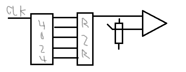

Does anyone know how to simply filter out adjustable number of pulses from the clock? For example: first gets through, the second to tenth are ignored, the eleventh passes again, and again and again..I think about monostable with variable pulse lenght and behind it clocked NAND gate.
It is about not to make it complicated, I need four of these circuits.Thanks for your inspiration.

gabbagabi
Joined: Nov 29, 2008
Posts: 652
Location: Berlin by n8
PostPosted: Thu Sep 06, 2018 6:33 am    Post subject: Reply with quote  Mark this post and the followings unread
this is what comes to my mind quickly
yeah, something like that but probably with a flip/flop instead of a NAND.
Does the pulsewidth of the output signal matter ?
@g.gabba that's a very neat idea and it doesn't need any adjustment if the frequency changes Very Happy
(maybe an extra AND gate at the output or something else so it can produce multiple pulses)

PostPosted: Thu Sep 06, 2018 7:32 am    Post subject: Reply with quote  Mark this post and the followings unread
@g.gabba Elegant solution, thanks. I´ll use one comparator for reseting the counter, to shorten the cycle, maybe better a switch with fixed resistors than pot.
