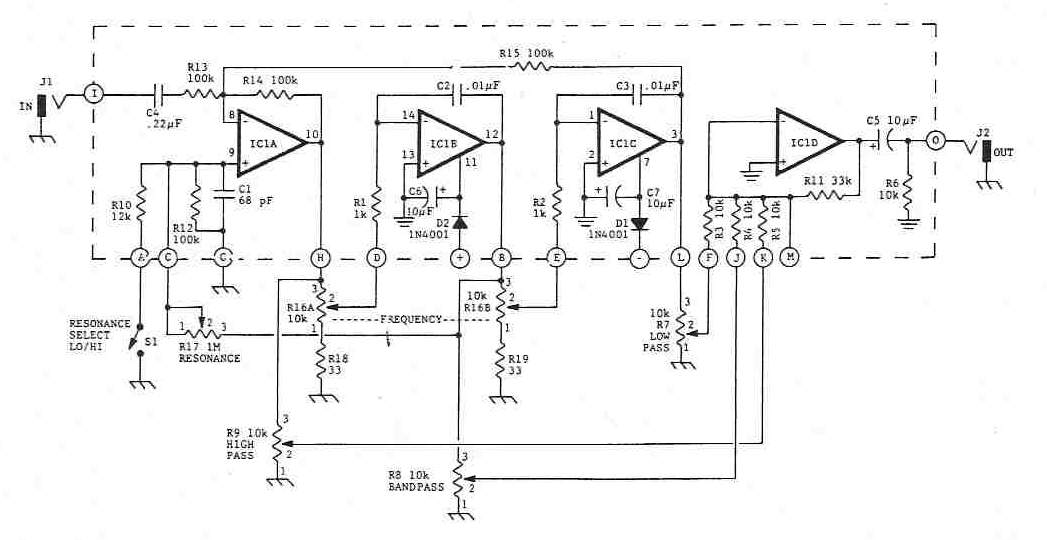

This might be just what I'm looking for...

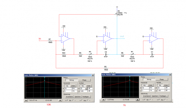

This ist a very easy to build sallen key filter, that usually utilize a dual pot instead of the vactrols...

MFOS State Variable Filter maybe? 12v -/+ with LP,BP,HP
I have this one on the bench, not completed just yet Twisted Evil
http://www.electro-music.com/forum/topic-53353.html
