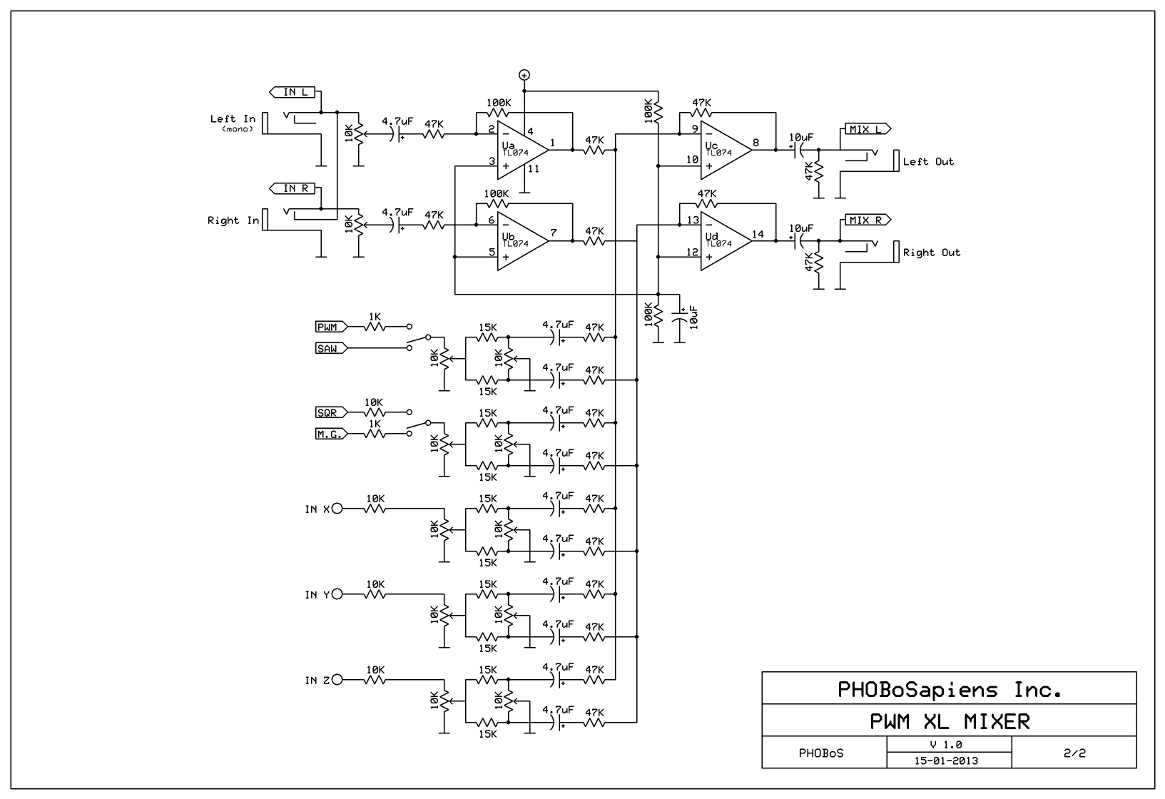

Posts: 5795
PostPosted: Wed Jul 03, 2019 1:57 pm    Post subject: Reply with quote  Mark this post and the followings unread
Just as an experiment, I tried voltage follower in several parts of the circuit for the + power rail and it got rid of all the noise that the caps to ground hadn't been able to handle although it reduced the + rail to something like 11.77 instead of 12v.
Most interesting, if anything I would have expected it to make it worse. I guess it might be limiting the current and having a
similar effect as placing a resistor in series.
Here's the schematic for a single supply mixer I made couple years ago. Don't pay to much attention to the component values
but as you can see I placed capacitors after the panning pots instead of the level pots. Because of this that section doesn't need
a fake ground and I only used it as a reference voltage for the opamps.
