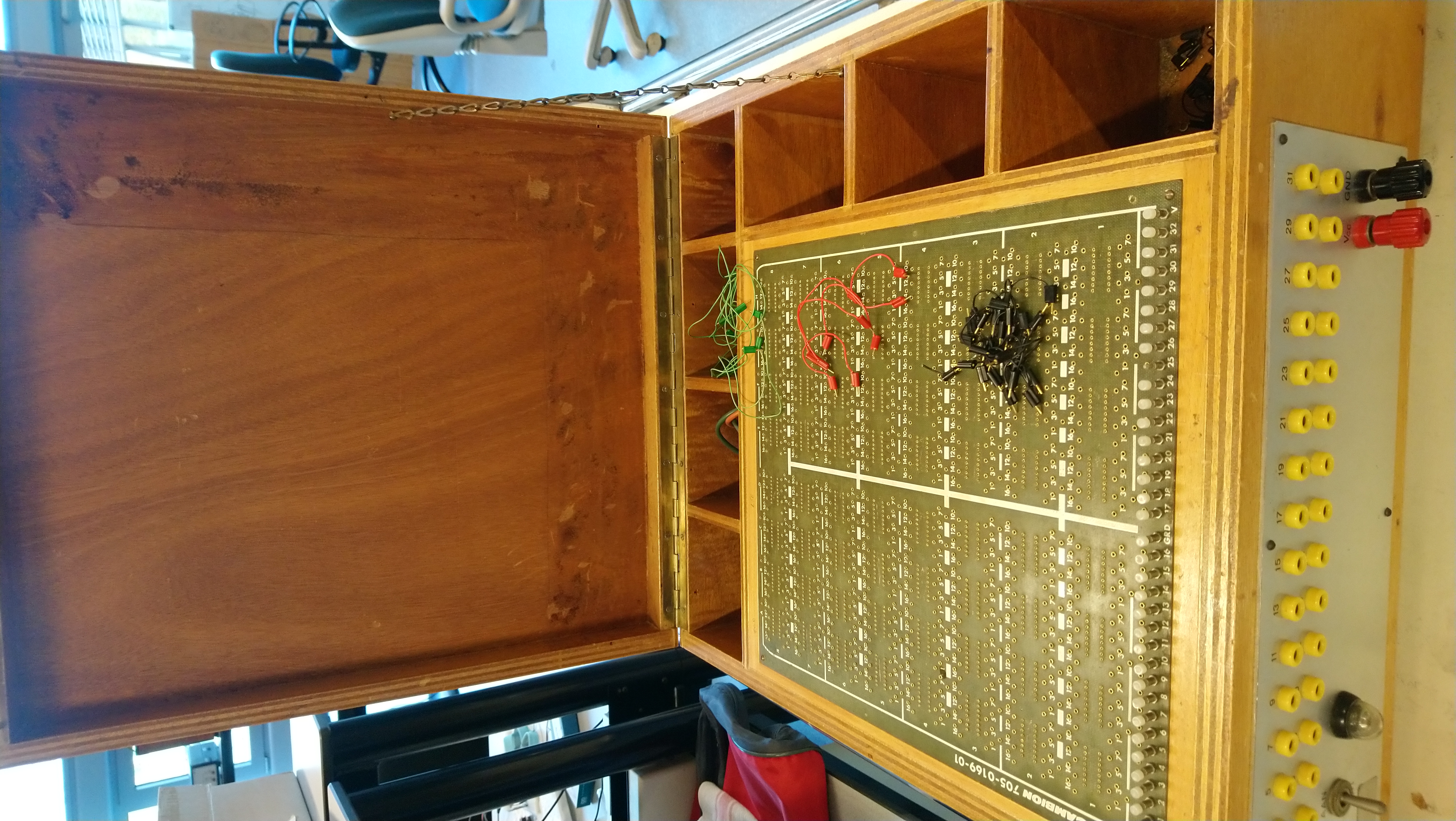

Used this in the old days Laughing

that's beautiful!
