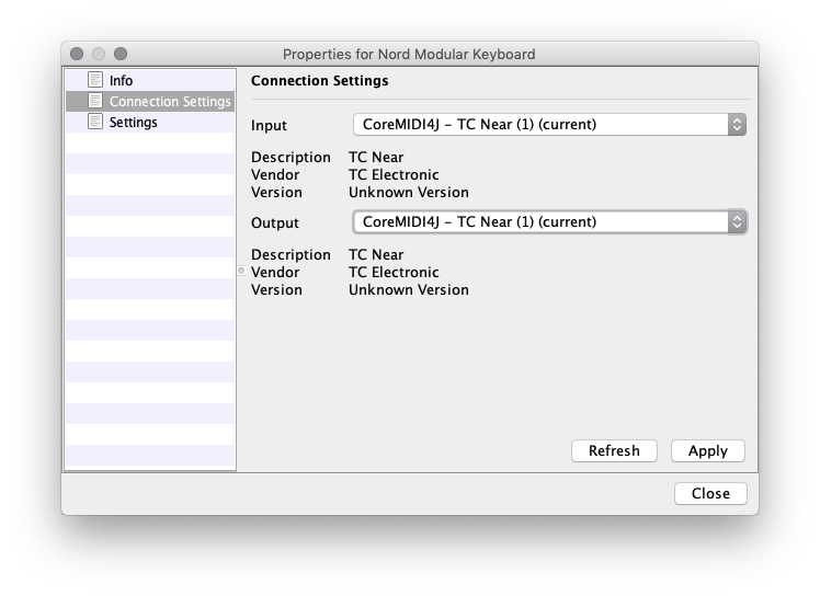

Some pics to illustrate the virtual MIDI port thingie.
this is how my MIDI ports look in MIDI studio (Utilities/Audio MIDI setup.app)
 Filesize:  75.81 KB
 Viewed:  220 Time(s)
These are the virtual ports created by Nomad, watch the CoreMIDI4J prefix - those are the ones to be used
 Filesize:  93.91 KB
 Viewed:  227 Time(s)
And this has been running without loosing contact for well over a week now
 Filesize:  615.06 KB
 Viewed:  227 Time(s)
