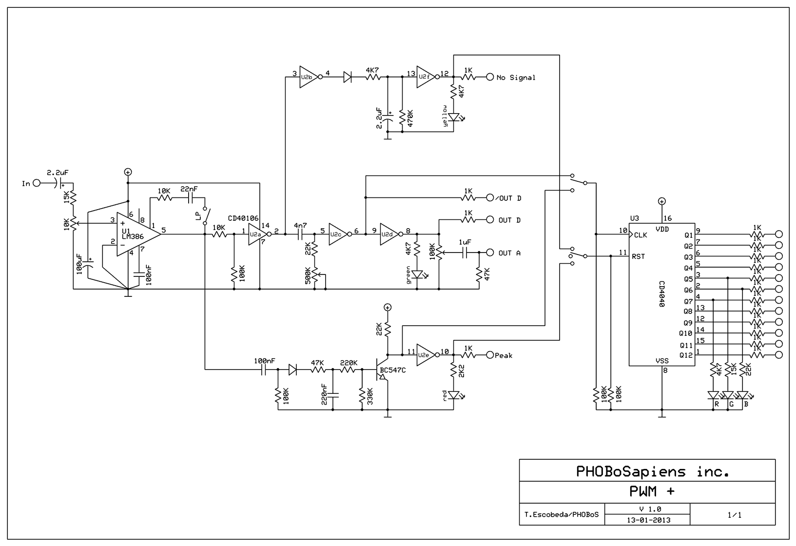

I also have some ideas and am unsure if some builds already exist. Namely, I'm looking for a PWM and a chorus effect (ideally separate pieces, so I can understand them).
Can't really help you with the chorus,. but one very simple way of creating PWM control is with an XOR gate, a potentiometer, a diode and a capacitor.
The downside of this circuit is that the dutycyle is frequency dependent, but it is a nice feature to add when using a 4046 as a VCO since that one
has a build in XOR gate. Note that the circuit was posted in this CMOS PWM thread together with some other PWM circuits.

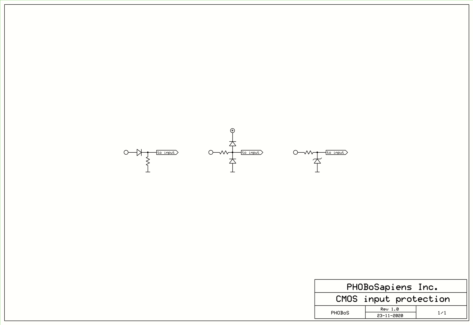

Awesome, thanks! One last (probably obvious) question: where exactly are the diodes being placed in the schematic, and in what direction? I'm still trying to really wrap my head around this part.
Posts: 5828
PostPosted: Mon Nov 23, 2020 4:16 pm    Post subject: Reply with quote  Mark this post and the followings unread
sure, take your pick.
The left one is the most basic one which will only protect against negative voltages not overvoltage.
It works fine if your whole system uses the same voltage but not if for example your CMOS circuit is powered with +5V
and you connect +12V (or anything >+5V) to an input. There is also a voltage drop caused by the diode but it's only about
0.6V for silicium and you can reduce it to about 0.3V if you use a schottky diode.
The middle one does protect against both negative and overvoltage, I would recommend using schottky diodes for this method.
note that this is often already integrated into CMOS chips but that's only for very low currents and to protect against electrostatic
discharge.
The right one also protects against both with the help of a single zenerdiode but can require a bit more current to function properly.
