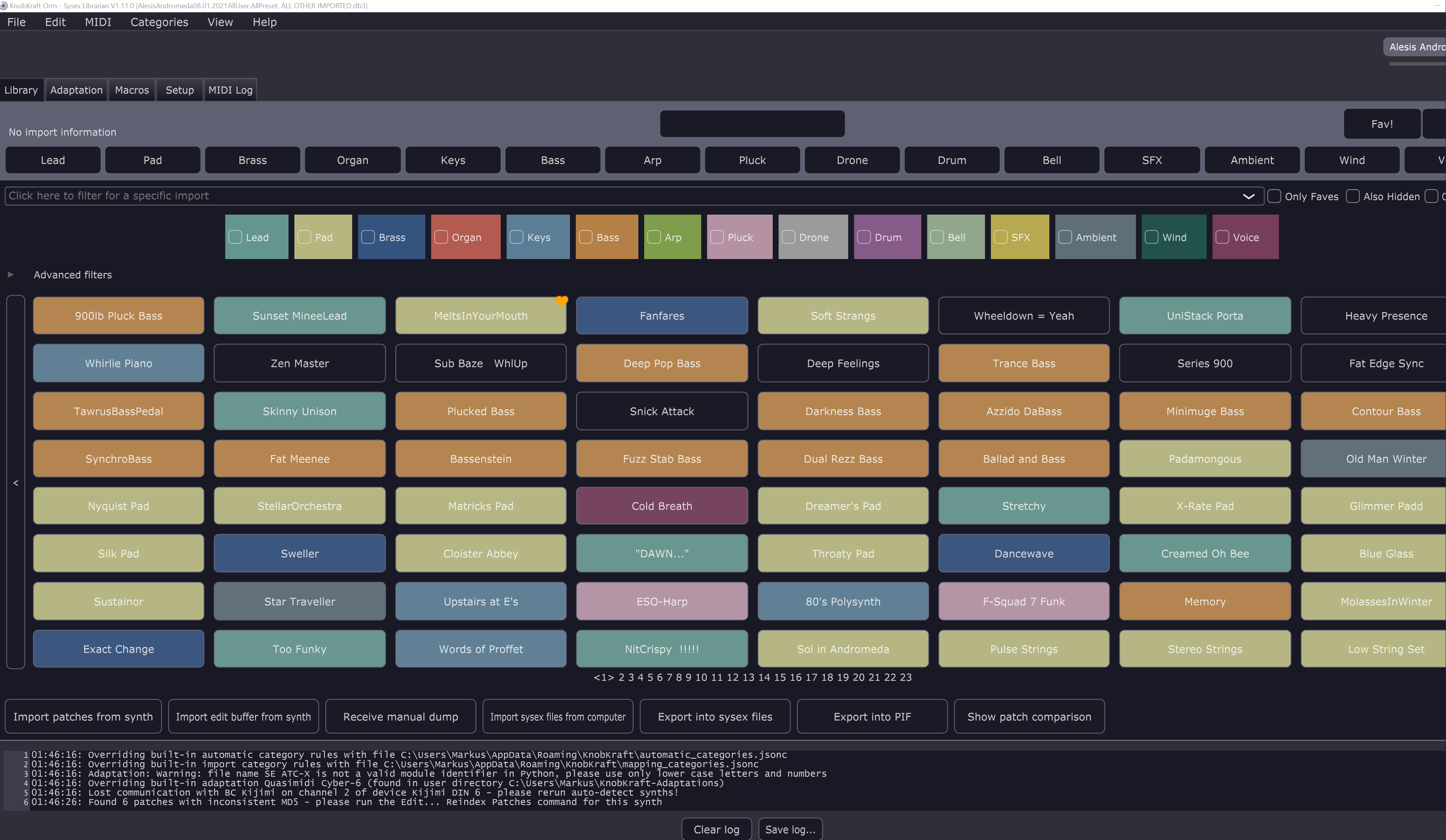

FYI There is a new librarian in town for the Andromeda (among quite a handful of other synths) and it's called "Knobkraft".
It's open source and, while still quite fresh, has opened up the Andromeda for me a lot! I've successfully imported all the available internet patches (many from here, so thanks!), scanned thru them and categorized them (and found great ones).
It features a duplicate detection via fingerprinting, is cross-platform, touch-UI and you can also write your own adaptation should your synth not be supported.
Now because of a couple of quirks in the A6's sysex implementation, you currently cannot SEND an edit buffer FROM knobkraft TO the A6, but you can receive them, which is great when you manually do something on the A6 and just wanna store that for later.
Because the A6 has no receive edit buffer (it does, but it doesn't work), the workaround is to send new patches from knobkraft to the A6 to the User Bank, Program 127 (but for that you need to select that beforehand, see text from manual down below!) and then knobkraft does a program change to that program.

I have attached a screenshot (btw I also use it on my touch screen laptop near the synths, because the UI is touch friendly 🙂 )
