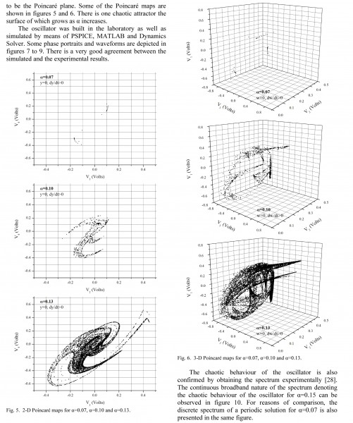

I like browsing thru various Chaos Generators circuits that can be found online and there are so many , the article i share also has little pointers as to where you can replace resistors with pots ,and shares the findings in waveform according to resistance so one can just place the correct potentiometar in the right place ,however this is mostly curiosity ,i wonder if this can be adapted for synth use , i like chaos generators and i see also AD633 is available a ali ,check the full article for parts values and very in depth look at this circuit
Chaotic and Hyperchaotic Self-Oscillations of Lambda Diode
Article by Jiri Petrzela
link : https://www.mdpi.com/2076-3417/11/8/3326/htm

I don't understand the circuit, but in principle:
- each resistor can be replaced by a pot
- if it should be voltage controlled, use a vactrol instead of a pot
- the result to be output should be buffered by a voltage follower and an 1k resistor, eventually level shifted and amplified to +/- 5V or whatever you need in your modular.

what i meant is in order to adapt this for synth use it's best to use breadboard to test various values or if some of the opamps can take well external cv in order to synch .let's say similar to the Jerk module by non linear circuits ,or modify it to change freq besides waveform and so on . ,this exact article is very well written and also points out the resistors that can vary in order to change the way of the oscillations , it also mentions that further variables exist but were not documented ,i see it as one fun LFO or something along that line , but what i really like is that there is true experiment and invention instead of boring optimizations and buffering all over the place ,it's one thing that synth world is missing as i would like to believe there is lot of yet to be discovered even without the digital extension ,i don't work much on breadboard , i have one but i almost never use it ,as i always hurry to build whatever is next module and play with the synth
anyways here's another chaos circuit that i found this one at first glance appears can take external cv to drive it it is 2 x AD633 ,LM311 ,and Opamps
http://wesleythio.com/thio13.pdf ,the article is called - A Chaotic Circuit for Producing Gaussian Random Numbers
