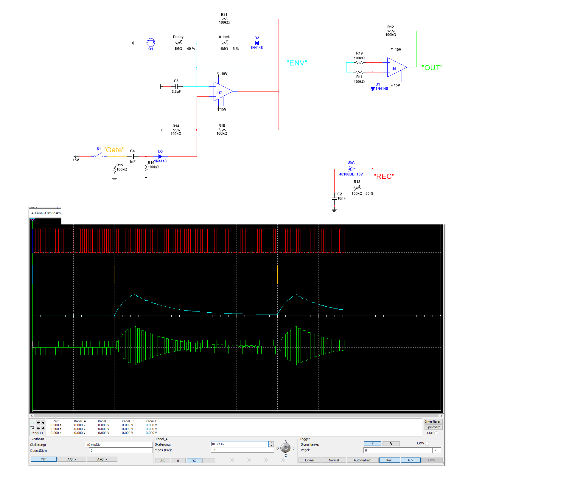

gabbagabi
Joined: Nov 29, 2008
Posts: 652
Location: Berlin by n8
PostPosted: Mon Mar 14, 2022 6:27 am    Post subject: Reply with quote  Mark this post and the followings unread
attached the simulation,
it is a little variation which ,in my opinion, is worth to try,
instead of the transistor we have now a diode on the
REC Input of the "so called" VCA,
which makes a potential stripboard design even more simple.
in the simulation there are a lot of "glitches",
not shure if they are appear also in reality,
but you have a breadboard Smile
the input resistance of the VCA with 1M does not take a lot of current out of the Envelope, so there is no buffer anymore.
(Since there is no Schemo for the LMNC-Envelope, i used my one meanwhile Cool )
