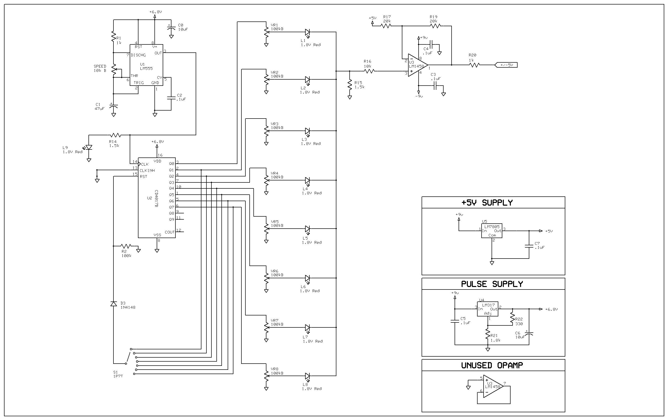

PostPosted: Thu Jan 25, 2018 5:48 pm    Post subject: Another Troubled Sequencer
Subject description: ...it worked on the breadboard....
Howdy Gents!
I've been visiting this site for years and this forum has been a favorite. Its been said that the 4017 sequencer circuit is a rite of passage. Now that I've hit a bit of a snag in my sequencer build I pass another rite - asking for help on electro-music!
Please see attached, a basic 8-stepper with a 555 driving the 4017. The pulse from the 4017 goes through a 100k linear pot and then through a red LED with a 1.8V drop (instead of a 1N914 or other diode). In this way the LED gives a visual representation of the relative voltage passing through. I adjust voltage into the 4017 with a 317 so after the LED I have a 0-5V CV. This pulse is then level shifted by an opamp to a +/- 5V to work with other things...
I could swear this worked on the breadboard but now that it is all wired up on perf I get unsatisfactory behavior. Basically my nice linear pot acts like an anti-log pot so that in the first 5 degrees of rotation I have rapid voltage change and after that it flattens out. The level shift circuit behaves accordingly.
I've tried everything (?) to debug it! if I bypass the LED with a jumper the pot behaves the same way. If I run the 4017 off +9V the pot behaves the same way. If I place different value resistors in parallel with the pot, the pot behaves the same way. And when I say pot I mean all the pots, they all act anti-log.
I know the pots are regular linear - easy to measure! Just can't figure out how this pot change is happening! Does anyone have a clue?
Thanks in advance!!

PostPosted: Sun Oct 08, 2023 11:58 am    Post subject: Reply with quote  Mark this post and the followings unread
You can also do this circuit with other chips.
For example a clock a CD4520 and a CD4099.
Many ways to do the same thing!
