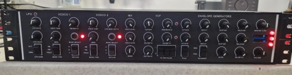

I think technically this is a microprocessor based synth as it uses 2 RP2040's for the oscillators, an Arduinoi NANO for MIDI to CV and a Teensy for programmable options.
This is a take on the Hagiwo $9 VCO based on the Seeed XIAO RP2040 SOC. I bought several of these with the intentions of making a polysynth, but I went another route and used a pair of these for a mono synth with interesting specs.
Dual VCO
24 waveforms per VCO
Portamento
Aftertouch
24db multipole VCF like the Matrix 12
Dual ADSR inc LOG/LIN and looping envelopes
16 waveform LFO
Many other things I've forgotten
