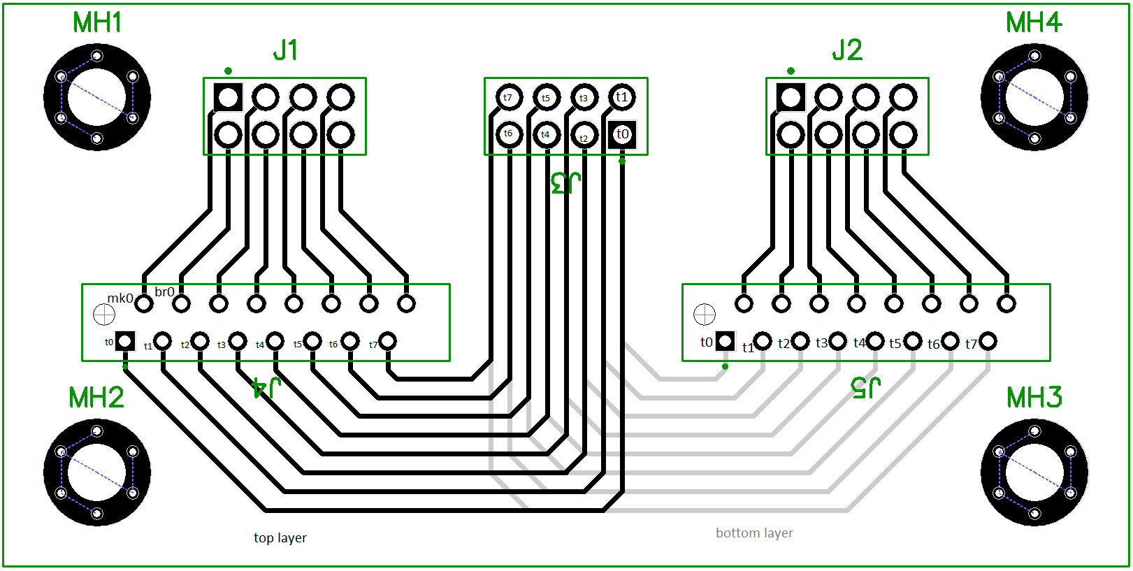

greetings,
i'm trying to make a fatar keybed column pins merge and micro-match to header pin adapter pcb
the pin-out for 61 key is available but i'm not sure about the correct pins as the retention pin is not located at the schematic and this confused me to locate the pin number 0 or the pins of the columns t0 to t7
i need some help if anyone here is familiar with this

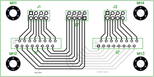

with respect to other resource i've found, it's a schematic from fatar for tp/100LR , the pin of t0 is the second pin not the first pin, this implies the the traces of the pcb i've design are wrong and need to re-trace the pins

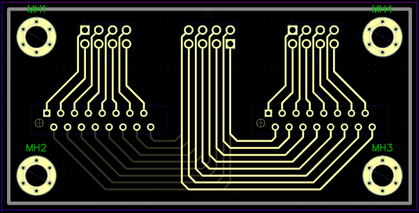

corrected - connector pins should have been placed at the bottom side of the pcb
