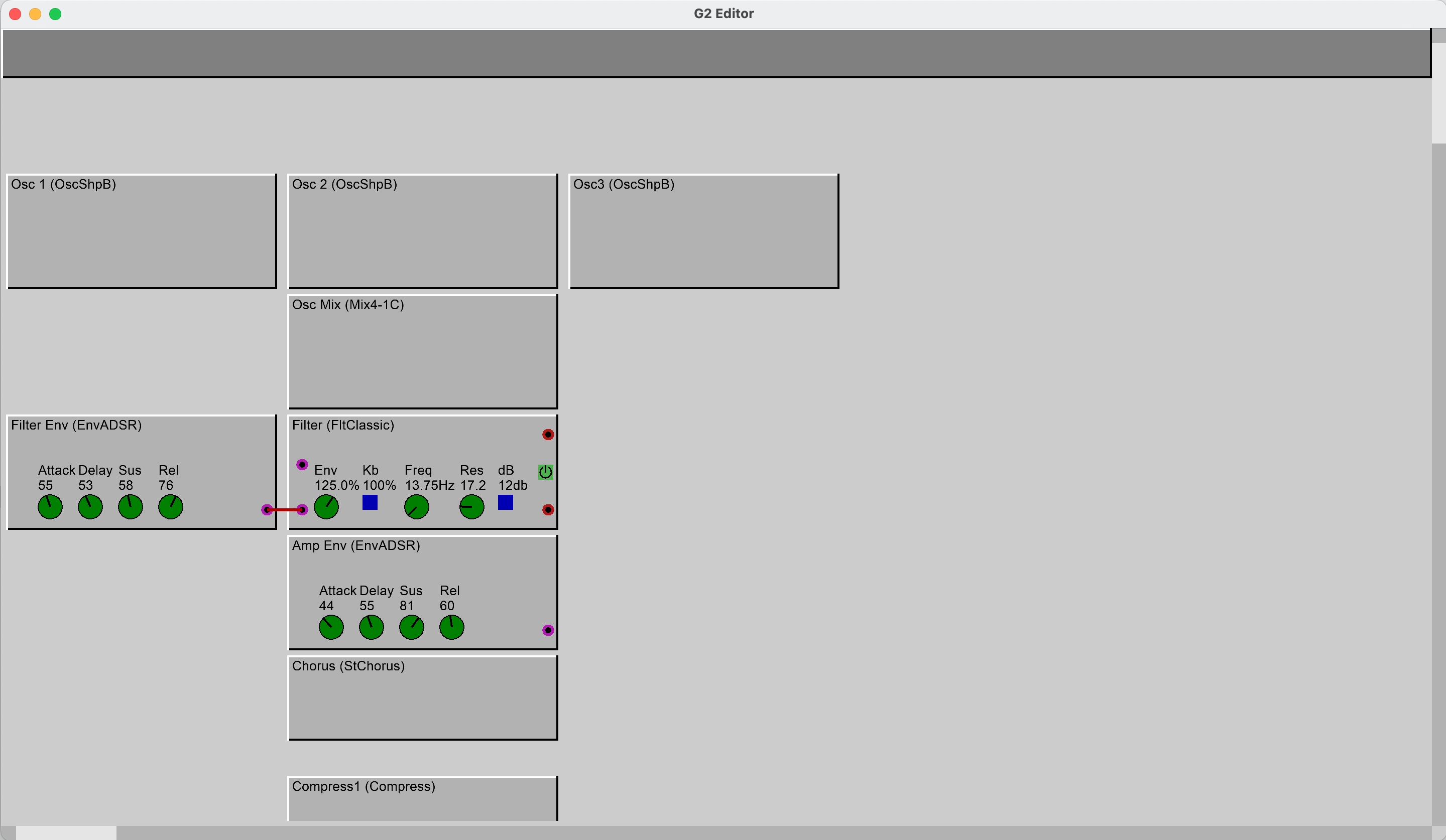

PostPosted: Sat Feb 22, 2025 9:26 am    Post subject: Reply with quote  Mark this post and the followings unread
All. I'm making progress.
Rendering a couple of modules, which have some working parameters reading/writing to the synth. The GUI dials work. Buttons also work.
...and breaking news - my first cable connecting modules!
If there are any 'C' or C++ programmers around here who want to get involved, drop me a line. This is quite a big set of work for one person to finish and I'm potentially getting involved in a day-job contract soon!

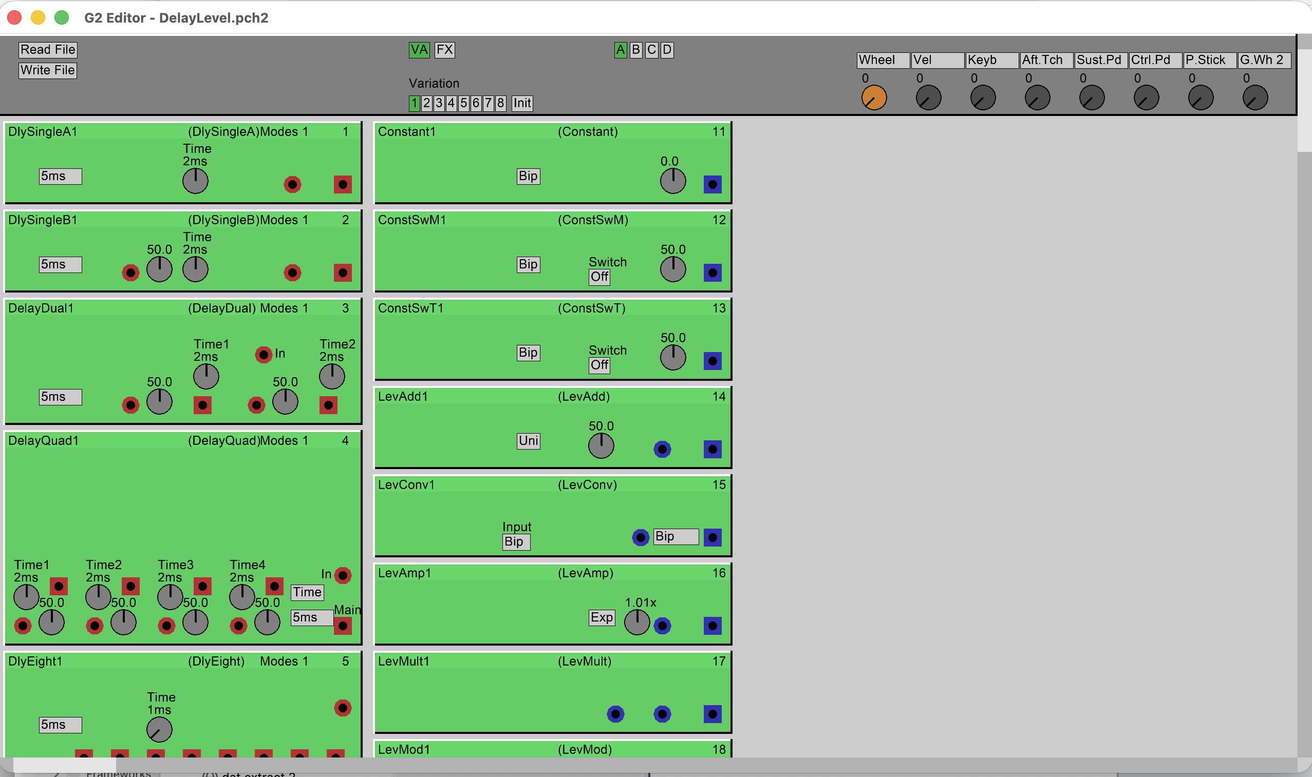

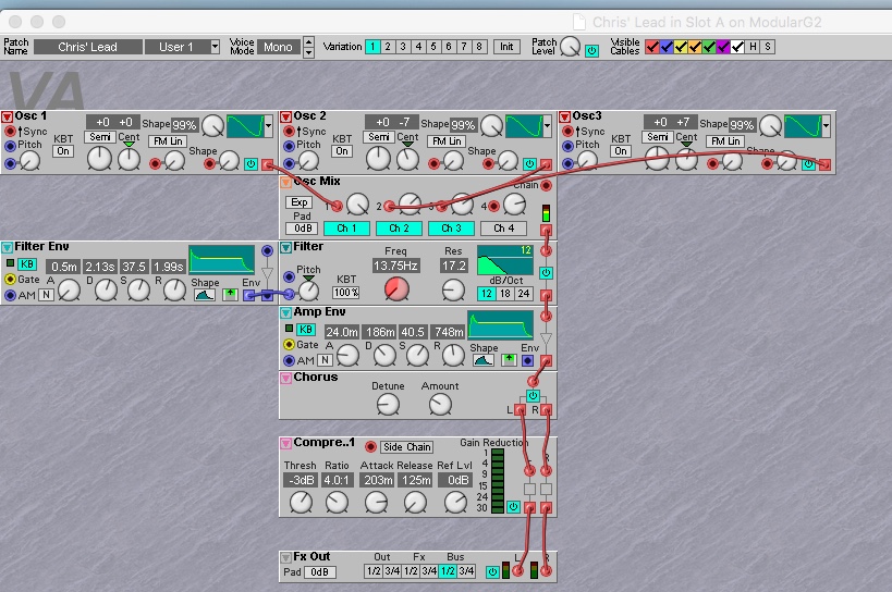

ChrisPurusha
Joined: Sep 09, 2024
Posts: 28
PostPosted: Sat Feb 22, 2025 9:35 am    Post subject: Reply with quote  Mark this post and the followings unread
This is the old editor representation of the same very simple patch, for comparison. So, module representation is working. Need to populate all the different module types (which is arguably the main slog). Lots of other work to do for completion: file access, variations, module creation/deletion and dragging etc. cable creation/deletion. All the stuff which needs to go onto menus.
Also want to make the module area zoom-able, which should be possible.

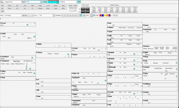

PostPosted: Wed Aug 06, 2025 3:09 pm    Post subject: Reply with quote  Mark this post and the followings unread
NordG3 wrote:
Not sure when to expect a working macOS v15/v16+ compatible G2 editor but I'm excited about it. Love the G2fx.png G2 interface image. Massive imrpovement over the original editor/G2 source Delphi redo. Looks fancy.
Thanks! Still plowing ahead. Wireframes for module done ... pics below!
HELP: I realized one thing I could use help with at some point is packaging this thing for multiple platforms. The project is ready for this from a build/deps perspective, since there will be no additional deps being added.
Suggested approach is to investigate what Idea IDE offers. I'm using Idea (plus OpenJDK Temurin, not a big fan of Oracle), although I haven't checked in Idea stuff, so if this is hard to set up let me know.
One possible problem is that Idea might want the project to be a "java module", but one of my deps, usb4java, doesn't export a module, so my project is not a module either. These darn kids with their java modules (emerged after I left prof. Java dev Smile ).
 Filesize:  262.05 KB
 Viewed:  105 Time(s)

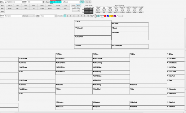

PostPosted: Sun Aug 17, 2025 8:43 am    Post subject: Reply with quote  Mark this post and the followings unread
More progress. The yaml made from the open-source code is starting to pay off, "power buttons", text toggles (e.g. "KB", "Side Chain") are done, as well as text labels.
There's going to be plenty of tuning Smile but it's nice to see finally some re-use of brunov's tremendous effort!
 Filesize:  397.84 KB
 Viewed:  156 Time(s)
